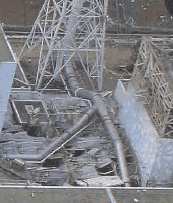

I believe that the #3 reactor did indeed blow it's top on March 14th. I see in these latest posts someone says that idea was shot down in March. I can find a lot of people trying to shoot it down. I can find no evidence where it's been shot down. If someone here can negate it, that makes me happy, as I've been very worried about it for two months.
I will provide two initial pictures which, along with the "collage" described above, will give you a pretty good visual that something large and round was ejected through the roof of Reactor 3 building.
I have gotten most of these photos from Nancy's site - which is excellent, and I see she is posting here.
The first picture is taken from above Reactor 4 toward reactor #3. What you will see is the wreckage of the roof laying over the building as it has for awhile. You can see the spent fuel pool with some steam or mist above it. In the roof beams, you can see an unmistakable large round hole that has been formed in a couple of large steel beams.
But the hole is in the wrong place, you say?
Nope, that hole was previously excactly above the reactor core. Now take a look at the second picture I show, which is a view of the same wreckage looking from west to east.
You can clearly see the roof beams laying across the wreckage. Look to the far left and you see a couple of wall beams still attached at the bottom and to the roof structure, but laying at an angle over the wreckage. When you spot them, you can see that the entire roof beam structure shifted to the south when it fell back down.
If you shift the whole structure back to the left in picture #2 then it puts the big round hole precisely over the reactor core from picture #1.
I believe that not only did the top of the reactor blow, but possibly the entire RPV ejected and landed in a few places around the plant, but a bunch of it landed on the north end of the wreckage of reactor #3.
For any of you that have been following me elsewhere, I've got a ton of supporting evidence, but I'll leave it at that now...

Well, on http://cryptome.org/eyeball/daiichi-npp/pict7a.jpg" picture you can see right through the rest of the damaged roof beams directly on the upper deck of the reactor.
Remarkebly, the deck is okay. In case the reactor went airborne, you'd at least suspect a big hole in the middle where the reactor lies. Not a smooth surface.
Moreover, I'd like to see the explosion which totally disintegrates the upper part of the RPV but otherwise only destroys the top of the building. If the upper part of the RPV really got ejected, we'd see it lying around on sat images. AND we'd see the bright, yellow containment cap somewhere in the vicinity. I think those things are in easily spottable colours for a reason.

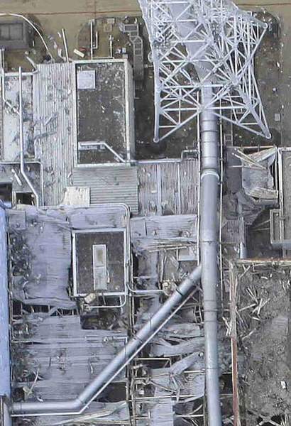

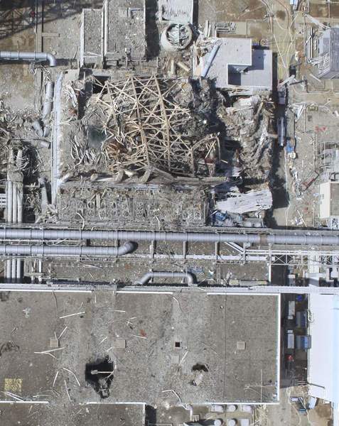

See attached satellite photo.
See previous "Houdini" post:
https://www.physicsforums.com/showpost.php?p=3235897&postcount=3307
Unless the "top" came out spinning like a frisbee, at an odd angle, to the side, and squirted out before the roof girders and large overhead crane could slam back in place, then it must still under there IMO.
Further, the thermal imagery doesn't correlate with the top plug of the primary containment vessel being gone and the smoldering barrel of an RPV that has shot its wad remaining. The residual steam venting to either side of the edge of the top at the SFP and equipment pool are hard to explain if the top plug isn't still there. BTW, the top plug of the reactor isn't a single slab of concrete, but is an alternating stack of semi-circular slabs 4 layers thick. Finally, there would be some very big, very radioactive chunks of concrete, a drywell cap, and the RPV top that remain unaccounted for if what you suggest actually happened.
Edit: oops -- almost forgot -- there was the pressure data from within the RPV following the explosion of Unit 3 that still indicated an intact RPV.
I, for one, am convinced it did not. So please pardon my intransigence if I refrain from any further debate with you (or Nancy) on this point.

ihatelies said:
In the roof beams, you can see an unmistakable large round hole that has been formed in a couple of large steel beams. But the hole is in the wrong place, you say? Nope, that hole was previously excactly above the reactor core.
Not really. The reactor core is precisely centered on the building in the N-S direction, so it lies exactly under the central roof beam -- which is one of the two beams that are still intact, and in fact the only one that is still attached to a pillar on the east side.
Moreover, as others have observed, the massive overhead crane is now lying on the service floor, astride the reactor well. (Indeed it must have been the crane that protected that roof beam from the blast.) It is hard to explain how it could have ended up there after the catastrophic explosion you have imagined.
On the other hand, there may still be a slim chance that the drywell and/or its yellow cap may have ruptured and contributed to the damage, e.g. if the falling crane cracked the concrete enclosure of the drywell or pushed some debris down the reactor well. In that case the crane may have deflected the blast to the sides, again protecting the central roof beam. However, if the shield plugs were in place, that seems rather unlikely.
One thing that puzzles *me* is the demolition of the NW corner of the steam-dryer pool (SDP), whose walls seem to be a bit thicker than the walls of the building. I thought that perhaps it was a blast of steam from the ruptured drywell. But the T-Hawk photo posted by TCups shows the SDP gate is intact. Unless it blasted into the 4th storey (below the service floor) ...
Moreover, as others have noted, the drywell continued to hold substantial pressure after the explosion. On the other hand, it lost all pressure on march 21, when the Black Smoke event started. The reactor temperature went wild at the time.
Quite puzzling.

Upon further review, I guess I was wrong about the damage to the 3 and 4 superstructures in the new pix.
Looks mostly the same as it was then.
I think I got fooled by all the steam in the earlier images, and by the altered positioning of the boom over SPF 4.
Sorry to jump the gun.

Another question (again, please forgive me if I've missed some previous conclusions on this topic):
After two full months, have we gotten ANY information indicating just what it was that crashed through the roof of the Turbine Building of 3, and left that beautifully-shaped hole?
(And if not, why the hell not? Are you telling me Tepco hasn't peeked in that hole for two months now, and has no idea what it was?)
Thanks.

Um... how do you like "Nobody asked TEPCO about the hole" as an explanation...?

Ah, grasshopper! Study the photo carefully and then answer your own question. :wink:
https://www.physicsforums.com/attachment.php?attachmentid=35384&d=1305067331

Could I have the answer, please? There's so much in those pictures I'd like to see or I believe to see that I've come to the conclusion to only talk about what I'm _not_ seeing there... ^^Another topic:

The panels that blew out of the east side of Unit 3's upper floor did one of two things. They either 1) cleared the rear facade of the roof of the turbine building, then skidded along the roof, smashing through the front facade of the roof of the turbine building, or, 2) they didn't quite clear the rear facade of the roof of the turbine building, whereupon, they smashed the rear facade, flipped upward, then crashed through the roof. The holes (pleural) in the roof of Turbine Bldg 3 were caused by blown out wall panels, or pieces of them, that followed the later of the two paths.
Did you read the second part of my post? The second picture I posted proves it didn't have to come off "spinning like a frisbee". The entire roof structure is moved exactly one section to the south. Which puts that hole directly over the reactor core.
And I don't necessarily believe the thermal imagery, since it showed the whole shebang as at very low temps.
So first off, do you believe something went vertical through that hole?
