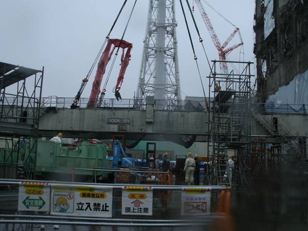

jlduh said:
To me, looking at several pictures, this pipe has been broken by the n°3 explosion (probably falling wall).
... and the mysterious green-scaffold-builder were there ...

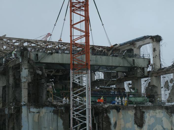

Where did you get this picture? When was it taken? Are you sure it was there (the scaffold builder) when the explosion occurred? I don't see it on the pictures...
Probably a stupid remark, and I don't know if this has been discussed already but i find something strange in the way this vent has been destroyed: the remaining part of the tubing at the west side is in perfect shape, including the very end of it, where the part that fell was supposed to be connected... That's quite bizarre, because if the part that fell was crushed by the falling wall, one could imagine that the remaining end would have so damages at the jonction. Here it's perfect! The comparision with the other side is very self explanatory of what I mean...
Something else is strange: from the top view, we have the impression that the fallen part is in fact TOO SHORT to cover the whole initial distance, like if one part of the tubing was missing?
http://www.netimago.com/image_200771.html
I mention this because it looks strange and also because of the scaffold builder you mention, with an idea in mind: could it be possible that they were doing some maintenance on the vent at this place, so the pipe was disconnected at this point when explosion happened?
Of interest, on later pictures, we can see that the curved tubing that was intact after the explosion in now... bent towards the ground!
See it:
http://www.netimago.com/image_200769.html
Do you think they bent it purposely in between? Why? For the crane to go maybe?
Either that or perhaps it was damaged when the control room concrete from the south west corner of the building fell (we don't know when this fell, or even if it was deliberately removed, but at some point it goes from being still attached to the building to being on the ground.)
I found that old picture from Reuters here:
http://hken.ibtimes.com/articles/124108/20110318/fukushima-daiichi-nuclear-power-plant-risks-at-each-reactor-japan-stricken-plant.htm
It is from 2008, so their work should be done.
Very good observations from you, but my english ist too limited to discuss in this professional circle. Let me say just thanks to all contributors of this excellent thread!
Ok, thanks, if it's 2008 the work should be finished, yes :smile: I was thinking of a recent picture just before the accident...
