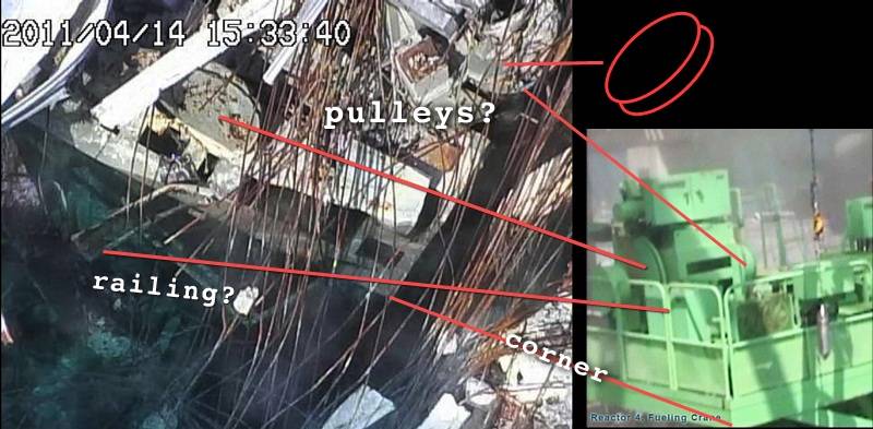

GJBRKS said:
(off topic)
What else here is yellow ( not yellowcake I presume ?)
Going further off topic. Rock wool is yellow. It is found in roofs, for purposes of insulation.
I cannot imagine a kind of explosion that would smash that cap into tiny little pieces. Not even a nuke could do that, the cap would vaporize first.
Small explosions might rock it a bit off its seat or maybe bust a hole clean through if there was something small and heavy inside that got propelled real fast by a high speed blast (another thing I don't believe in, because the horrible amount of damage suggests low speed, long pulse, plenty of time for concrete to realize what's happening and start to crack).
Big explosions could make it fly off as a whole or maybe (maybe!) crack at a seam and open up like a can of sardines, IF it has any seams, IF it was too well anchored.
I do not believe in many small chunks of high-grade steel, all of them falling painted side up and not scorched/blackened by soot in the aftermath of the explosion that made them part company.

Find attached photos from two angles of a cylindrical oject lying leaned to the roof wall of turbine building 3. Seen from the THawk angle, one can well interpret the object as being connected to the piping there, i.e part of the original installation, albeit somewhat damaged. However, seen from the west in a zoom from one of the herostratic high resolution photos, it can be seen that it is not mounted, but has crashed on top of the original pipe. It has not been possible for me to find any satellite photo from before the unit3 explosion showing this object. So, I am led to believe that this object could be one of the ballistic objects. I have no idea what it could be, and where it sat in the building before the explosion. No high hopes that anybody can identify it, there are few clues except shape and a peculiar coat it appears to have been lined with.
