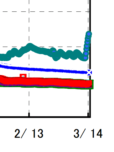

PietKuip said:
Page 30 shows CAMS readings from the Unit 2 suppression chamber (B) from the middle of April till now. I cannot really pinpoint dates, but there are large peaks (up to 160 Sv/h) with a valley of about 40 Sv/h.
There seems to be a correlation with drywell temperature RPV (C):
http://www.ic.unicamp.br/~stolfi/EXPORT/projects/fukushima/plots/cur/plot-un3-full.png
Is this where the corium is, in the middle of the torus? Is it going critical some weeks?
Beware, you compare readings from Unit 2 S/C and drywell temp RPV for Unit 3...

MadderDoc said:
It is also news to me from this document, that the RPV during the period of the 'black smoke event' on March 21st briefly peaked out at >12MPa, before it dropped back abruptly and went down to to atmospheric. My,my.
Are you talking about the graph page 41/66 of http://www.tepco.co.jp/nu/fukushima-np/plant-data/f1_8_Parameter_graph.pdf ?
3 data are between 8 and 12 MPa, but it is difficult for me to read the date more precisely than sometime between March 18th and March 23rd.
I am interested in any interpretation of what happened at any unit late on March 20th or early in the morning on March 21st, because I am curious about the radioactivity peak recorded in Mito at 6 AM on the morning of March 21st, as in most cities in Eastern Japan on that date, which I believe is also connected to the "don't give tap water to babies" crisis in Tokyo during the following days (http://www.guardian.co.uk/world/2011/mar/23/tokyo-water-unsafe-infants ).
My previous posts on that topic :
https://www.physicsforums.com/showthread.php?p=3258585#post3258585 (with Mito 6 AM March 21st peak attachment)
https://www.physicsforums.com/showthread.php?p=3258806#post3258806 (about the gap in Tepco data)
For what it's worth, I posted about Kenichi Ohmae's somewhat isolated view of black smoke being something serious at https://www.physicsforums.com/showthread.php?p=3229089&highlight=Ohmae#post3229089
