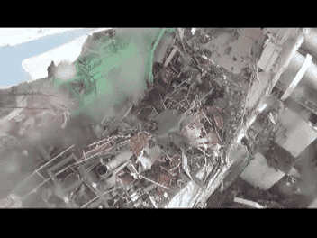

So I guess containment, even in the case of a powerful explosion is factored into the design. The design seems to be such that energy from an explosion would be partially channeled either sideways or down or both. In the absence of more information I think I'll avoid speculation.
There is the problem of radioactive contamination from Unit 3. Specifically, this evidence I again summarize and put forward to review. It has been previously released by various sources and discussed in several of the preceding posts in this thread:
1) the timeline of radiation spikes shows the highest spike immediately following the blast at Unit 3.
2) it was reported that workers were initially pulled back after the explosion at Unit 3 because of concern of radiation after the blast.
3) it was reported access to Unit 3 was temporarily limited by high level radiation on the ground
4) it was reported that military tanks with dozer blades were to be brought into clear the radioactive debris so work could continue (no pictures of that I have seen, or confirmation that it actually happened as far as I know).
5) an unsourced diagram that showed the locations of the highest levels of measured radiation on the ground around Fukushima 1,2,3 and 4 shows the highest levels around Bldg 3 and has a positive correlation with visible debris blasted from the east, west, and south sides of Bldg 3, including some higher readings on the east side of Turbine Bldg 3 where side wall panels of Reactor Bldg 3 blew across the roof.
A counter hypothesis might be that the explosion at Bldg 4 was from the SFP and SFP4 hydrogen production, and that this may have been the source of high level radioactive debris (less likely, IMO). Even so, if that were possible, then it is equally possible that the same mechanism may have been at play in whole or in part in the explosion of Bldg 3.
Therefore, I conclude that the blast from Unit 3 carried high level radioactive waste with it.
If so, then regarding this high level waste in the explosion debris of Unit 3:
1) was it from the spent fuel pool of 3?
2) was it from the (damaged) reactor core of Unit 3?
Ultimately, those would seem to be the only two sources of high level ground debris.
3) how could an explosion, if powered only by vented hydrogen from the containment of Unit 3, and originating from the top floor of Bldg 3, disperse high level waste as ground debris from either of these sources?
Think about it.

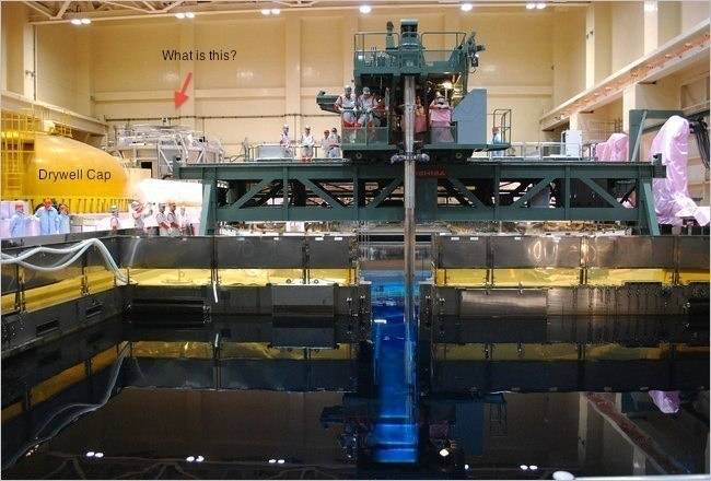

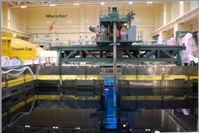

Well I've been considering some of the orange debris and wondered if some of it might not be a portion of the dry-well cap. And in keeping with your theory, a heavy steel dome shaped cap would be like the plate used in an explosive device for directional control (directional charge). In a dome like structure the point where it is attached to the upper reactor would seem a likely weak point, not to mention concerns that have been mentioned in the past about ensuring proper dry-well mounting.
If the orange debris is 3/4 inch steel section from the cap it would match your description sideways then upper energy release at unit 3.
Somewhere, way back there, there was a post about the color scheme of painting various equipment in a nuc power plant. In short, there may be lots of stuff painted different colors, including red.
I doubt that the drywell cap has been completely blown off and even if so, that it were blown, it was not exploded, shrapnel-like, into many small pieces. More likely, it would be yet another bullet-like projectile, along with the drywell plug. But that is just my SWAG (scientific wild - guess) vs. WAG (wild - guess). Remember that the cap would tend to vent hydrogen gas into the upper portions of the dry wall containment and region of the fuel transfer chute and gate under as little as 2 ATM of pressure, if previous post references are correct.

|Fred said:
Yes Astronuc, and according to this gentleman it sustained up to 8 before leaking http://www.ustream.tv/recorded/13414000
Now, What I 'm not sure to have right is: is this value is for the core (primary) or the drywell
Note the significant bolting of the Drywell Cap and the fact it has a relief valve on it. There is the hydrogen release point, if indeed the pressure rose to 8 atm. Normally reliefs are set at 125-150 percent of design relief pressure. That is unless the 4 atm included a 150 percent safety factor.

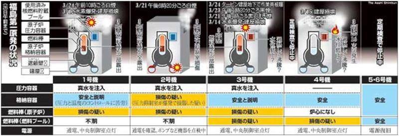

AntonL said:
https://www.physicsforums.com/attachment.php?attachmentid=33572&stc=1&d=1301164813
From above slide, and knowledge gained I revise what I posted earlier
Unit 1 - Explosion after venting - H2 leak in venting system
Unit 2 - Explosion at Torus - Torus has small leak, possibly a crack allowing H2 to vent.
Unit 3 - Explosion due to H2 leak at PVC-dome due to high pressure
Unit 4 - Explosion due to H2 generated in SFP
Core damage in all three working reactors.
And the water leak problem still to be found
Four units and four different failure modes leads to one conclusion:
BWR are not as safe as they are said to be. It is time to switch them off.
Conclusions already made by industry experts (see attached pdf file)
1. All existing power plants' passive emergency cooling systems (BWR's
RCIC and PWR's turbine-driven auxiliary feedwater system) should be inspected
and reinforced to assure their reliability during adverse condition. Onsite
emergency generators should be further protected.
2. PWR is more resilient than BWR because of its steam generator secondary
water inventory and size of containment. This gives larger margin to core damage
and containment failure. Further review is still necessary to improve the safety
level.
3. Spent fuel pool safety has been grossly overlooked. A hardened and
independent top spray system is necessary for all nuclear power plants.
Please read attached pdf file - the most authoritative analysis yet found.
Anton: At glance, I'd say you missed something on the Japanese slide. Look again, Grasshopper!
Unit 3 - Explosion due to H2 leak at PVC-dome due to high pressure AND H2 from SFP
But more to read. Thanks.
