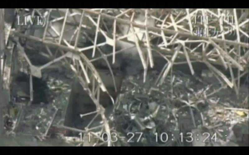

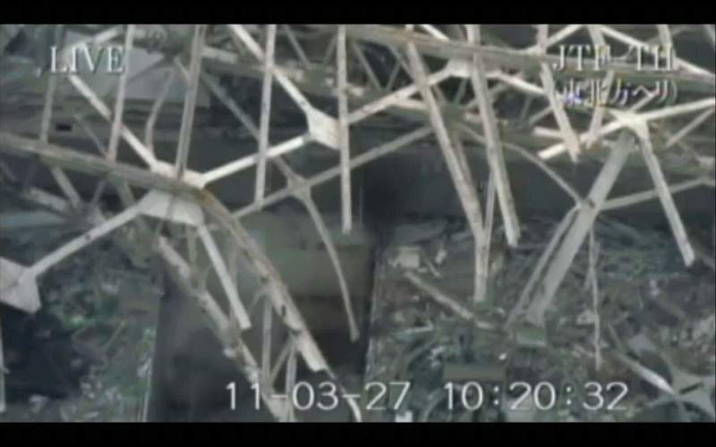

curious11 said:
If that's the case, does that mean the void in front of the gate (ie closer to the camera) in that image is the SFP, which appears empty in the frames prior to your screengrab?
"Ding, ding, ding"
Yes! -- at least the top of the SFP appears empty. What is down there 10 meters deep, I can't say. But it appears that the steam is coming from a jet on this video and earlier videos, and that jet seems to be from the side of the SFP near the region of where the gate would be. And whatever the structure is in the screen shot, it "appears" to be a slot-like channel in the upper end of the north side of the SFP of 3 with, perhaps a slab-like gate.
Maybe there are other interpretations.

TCups said:
"Ding, ding, ding"
For clarity : the view here is the same orientation as the heli-cam, so the suggestion is that the pool at the bottom of the image is now empty, and partially open to the east side of the building?
