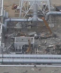

TCups said:

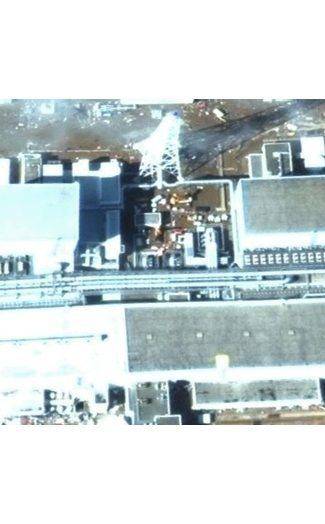

I had thought that the original blast at Bldg 3 is on the SOUTH end of the building. The damage on the north end sends stuff crashing downward. If the blast photo is taken from inland, looking eastward, then the blast is to the right, southward. Two towers bracket Bldg 4, on the blast (south) side of Bldg 3. A large hunk of debris comes down on the north side of Bldg 3. But the more I look, I can't make that orientation fit with the towers. Someone help me here.
The video of the blast is taken from the southwest. We see two walls of each reactor building, the south wall in the sun to the right, and the west wall in the shade, to the left. The middle antenna separates one from the other the other in the picture. That is, we see it aligned with the south-west edge of the building. Is that of any help?

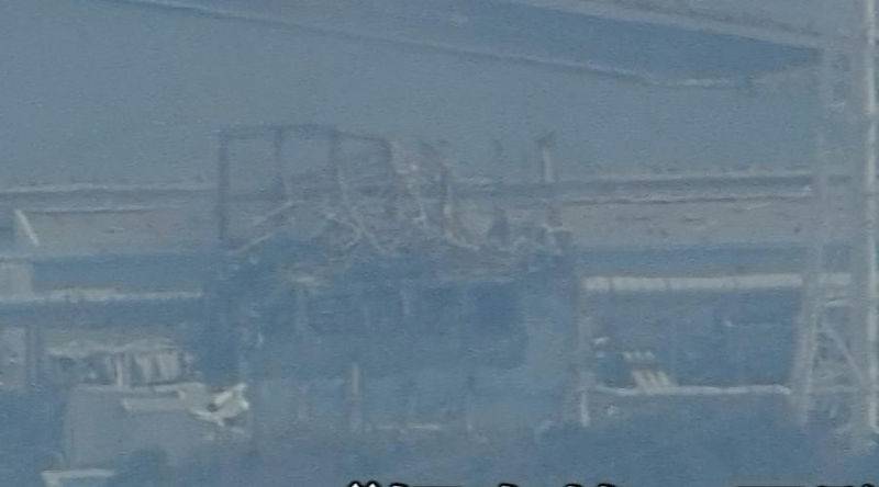

shogun338 said:
Damaged Reactor #4 video taken from pump truck . http://www.liveleak.com/view?i=30c_1301689134
What is the grey looking mass that looks like it has flowed from where the steam is coming from ? Looks almost like molten lead .

TCups said:
I can suggest one: superheated steam & gas blow out the fuel transfer chute into the upper SFP (water already hot, or boiling, rapidly vaporizing the water, and resulting in an upward focused blast out of the SFP, launching the FHM skyward, yanking a fuel rod assembly out of the pool as it shoots upward, then crashing on the north end of bldg 3.
http://i306.photobucket.com/albums/nn270/tcups/Picture28.png
http://i306.photobucket.com/albums/nn270/tcups/Top.png
Doesn't this view have to be from the west?
@TCups: look at 1:51 in this video. Something heavy is falling down and is deviated, or turned around, by the big antenna, so we can presume it landed very close to the antenna:
https://www.youtube.com/watch?v=YN8tzmtQv8g
Might that be part of the FHM?
EDIT: I corrected the youtube tags. Also, I am not completely sure whether the object I mentioned is turned around or it simply partly disappears behind the antenna. What seems clear is that at least three objects fall. Two simultaneously (or they might be parts of the same, big, object) one to the right and one slightly to the left of the antenna. Then a third one, about a second later, and to the right of the antenna...

@Tcups: Regarding your latest scenario (the flying fuelmachine). I can't find fault with it thus far, particularly because it ties together bits of information that didn't make sense before, especially how these rods could have ended up on that side of the building. While it seems a wild theory to have them attached to the entire FHM, which does a backflip through the air, it all fits with what we can see. Note that most damage to the buildings where the FHM now sits was caused by the explosion and debris of the wall BEFORE the machine landed on top of the rubble. Also for the FHM to be able to drag a fuel bundle along without it shearing off, it must have been propelled upward almost vertically, which corresponds with it landing close to its departure point.

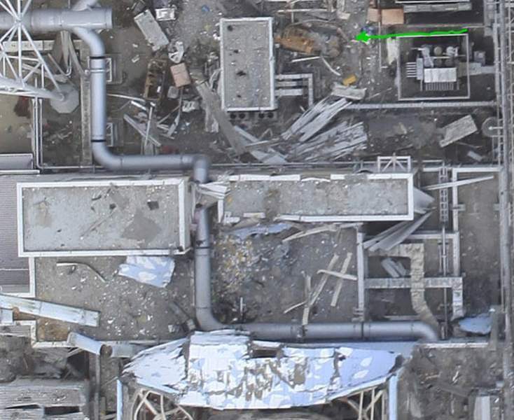

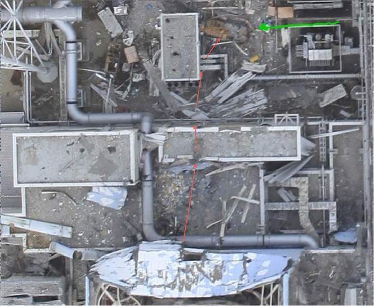

FLOOR PLAN LAYOUT OF REACTOR BUILDINGS 3 AND 4, TO SCALE, HIGH RESOLUTION
Astronuc said:
As for atomicinsights, I wouldn't put a lot of stock in the article.
The Fukushima units are not the same as Oyster Creek, even though they may have Mk I in common. I'm not aware of upper and lower SFP pools.
Astronuc:
'tis true Oyster Creek is probably a bit different layout. My Illustrator skills are not as good as Photoshop, but I took this diagram
http://www.flickr.com/photos/60551543@N04/5531996321/sizes/z/in/photostream/
Did a scaled overlay sketch of the floor plan layout of the reactor access floor . . .
http://i306.photobucket.com/albums/nn270/tcups/Picture63.png
Copied it to Photoshop and touched it up . . .
http://i306.photobucket.com/albums/nn270/tcups/TopFloor-Floorplan.jpg
Scaled the measurements and structures relative to the high resolution top down views from the fly-over provided by Fred's post (there is some distortion due to differences in perspective between the two buildings), and come up with something like this.
http://i306.photobucket.com/albums/nn270/tcups/aerial-floorplan.gif
It may not be exact, but I expect it's pretty darned close -- as close as I can come without the actual floor plans.
I believe there are upper and lower pools on the south side, but one of the pools, at least on the only diagram I seem to have that shows this region of a Mark I, is narrow and deep. It seems to have a transfer gate. Is it for temporary cask storage? One important feature, if the layout is correct -- the fuel handling machine would not straddle the additional small pool on the south side. It can be accessed with the large overhead crane. I the diagram, it would seem to be a place where the yellow cask being lifted up the chute would be placed, and in that location, the spent fuel rod assemblies could be placed "wet" in the fuel cask.
  • #2,425
REGARDING A BALLISTIC FUEL HANDLING MACHINE
If there were fuel handling operations in progress and the quake hit, then power failed and the reactor scrammed. It seems plausible that the operators would put the fuel assembly they were handling back in a safe position (if the fuel handling machine could draw power from the backup diesel generators, otherwise not), then get the heck out of there to see what was going on. Think about it -- working up there above the SPF and a big quake hits.
Also, I have absolutely no first hand experience, but from the pictures, the part of the fuel handling machine that handles the fuel assemblies is not a cable or anything like it. It looks like a rigid vertical arm, probably hydraulic, and I would be willing to bet it was built to be very precise, hold the fuel rod assemblies very securely, and put them in exactly the right spot.
If the blast resulted in the same initial trajectory and velocity of the FHM and attached fuel rod assembly, then, the point of impact would be about the same, I should think.
How about it Astronuc? What are the actual mechanics of a FHM and how does it attach to and secure a fuel rod assembly for movement?

@Tcups: It looks like the telescopic arm has an attachment that grasps one fuel assembly at a time. There is an attached camera to assist in locating the thing precisely, i.e. making sure the machine is placed exactly plumb with the assemblies in the storage rack or rector, so when it extracts vertically (because it is a boom, not a cable, there is little leeway), everything lines up.
  • #2,430
Bez999 said:
@TCups: It looks like the telescopic arm has an attachment that grasps one fuel assembly at a time. There is an attached camera to assist in locating the thing precisely, i.e. making sure the machine is placed exactly plumb with the assemblies in the storage rack or rector, so when it extracts vertically (because it is a boom, not a cable, there is little leeway), everything lines up.
Pure speculation, perhaps, but I think reasoned speculation on my part is that 60 is a number that might make sense for the number of individual alleged "fuel rods" seen at the alleged "crash site"
http://i306.photobucket.com/albums/nn270/tcups/903a9527.jpg
