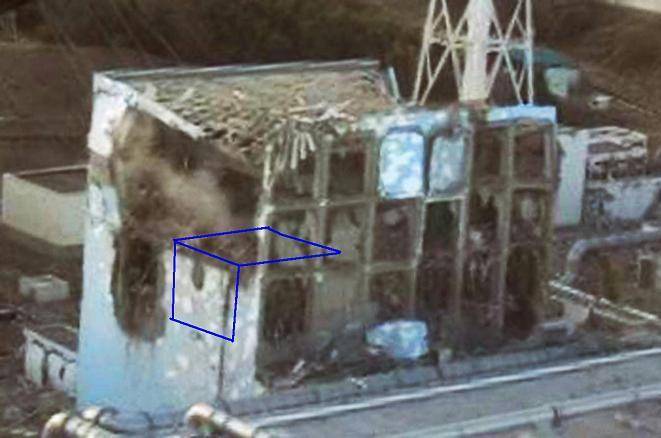

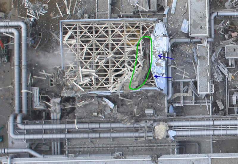

TCups said:
OK, that analysis fits pretty darned well compared to my earlier guesstimate:
https://www.physicsforums.com/attachment.php?attachmentid=33874&d=1301669768
https://www.physicsforums.com/attachment.php?attachmentid=33875&d=1301672183
Even the shadow on the south side of Bldg 4 lines up.
Here are a couple of additional questions for critical analysis by someone who knows and can critically analyze photos for that sort of thing, Anton:
Do the size, number and distribution of the rod like objects in this photo fit the description of the number of 4 meter x 3 cm (roughly?) individual fuel rods that might be in a single fuel rod assembly?
http://i306.photobucket.com/albums/nn270/tcups/64f1c409.jpg
Does it make sense that a flying fuel handling machine would drag an attached single fuel rod assembly behind like the tail of a kite and that the fuel rod assembly would smash open on top of the bulk of the FHM as the FHM impacts the building?
Do the girders about the proposed NE corner impact site look to be bent downwards vs the upward and outward bending at the blast site on the SE corner?
A 10x10 fuel assembly has individual fuel rods with a top plate and handle assembly, a bottom plate and nozzle, and three spacer plates. All rods are inserted through the spacer plates.
Fuel assemblies are not robust structrures. I have seen results of dropping new fuel assemblies prior to channeling which resulted in significant tamage to rods. They do not tolerate even small twisting or side loads. That is part of the reason each fuel assembly is also wrapped with a fuel channel, a square tube running the full length of the assembly. They remain channeled after the assembly is discharged to the spent fuel pool.
I know it is tempting to look for fuel rods, but I wouldn't be looking for 12 ft long intact rods. You are expecting these rods to find a way to get loose of its spacer plates and shroud after an explosion that was strong enough to blow the FHM sky high? I have a hard time accepting that.
Me too, but there it is. Most of the force of the blast was going upward, pushing on the fuel handling machine. The fuel rods just got carried along for the ride, not blasted skyward. The spacer plates burst when the fuel rods hit the building.
Here's a question. I bet the new fuel rods are more brittle than the spent fuel rods. From what little metallurgy I know, the heating in a nuclear reactor, then cooling in a SFP, and then maybe heating them again in the explosion might make them less brittle. There do appear to be a few fragmented ones, but few if any appear bent.
The odd thing is that we, the lay public, will most likely never know the exact details, unless Astronuc gets busy, goes over there, and gives us the first hand scoop.
Someone tell me about superheated steam as an explosive propellant, please.
Would steam be more likely to cary a heavy piece of equipment skyward than, say, the heat from a hydrogen blast? I know live steam is a special kind of hot gas with a lot of energy density. The only way I can seem to get enough oomph directly under the FHM to launch it like that, mostly in one piece (if my PhotoShop'ed picture is correct) is, perhaps, for the initial hydrogen blast to take out the roof and then, have the superheated steam from the SFP to to launch the FHM skyward immediately following the hydrogen blast. If freeze frames from a shaky video from way far away are sufficiently informative, that may have been what happened.

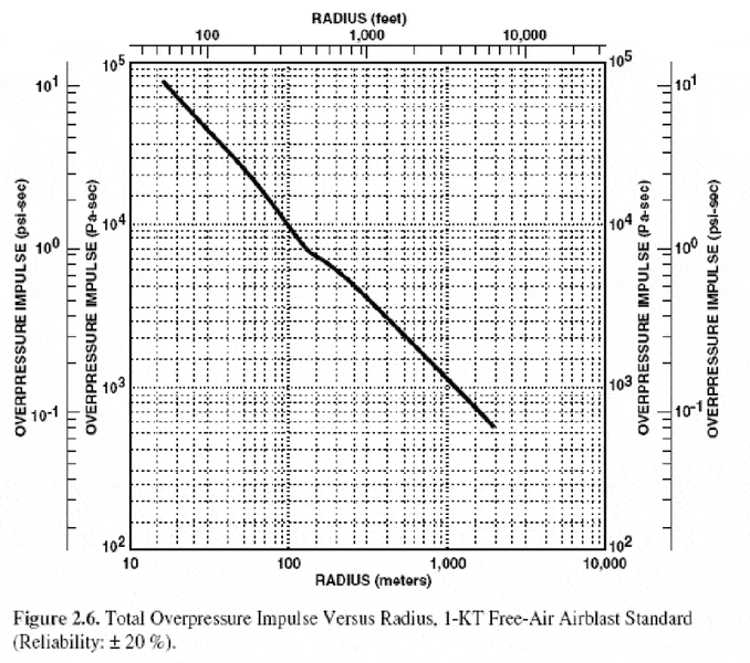

geb.es said:
The video of the blast is taken from the southwest. We see two walls of each reactor building, the south wall in the sun to the right, and the west wall in the shade, to the left. The middle antenna separates one from the other the other in the picture. That is, we see it aligned with the south-west edge of the building. Is that of any help?
I think I've finally figured out what everyone has been calling "antennas" The very tall structures are roughly 200 meters tall. They are the Offgas Stacks. During normal opearion steam and noncondensibles including raqdioactive isotopes are dran of the condensers through steam jet air ejectors and the offgas system then holds the effluent or filters it prior to release theough the offgas stack. During emergencied the Standby Gas Treatment System SBGTS of SGTS maintains a negative pressure in the secondary containment to route all potential leakage through filters and then to the stack for elevated release which increases dispersion of the leakage. If the plant has a hardened vent capability, when the containment is vented it also goes through the filters and stack. Don't need the first function (Offgas) once the turbine is tripped. Of course with the roof blown off the second function is gone. If indeed the containment is breached then the third function is also gone.
Once again, you can design systems to be foolproof. It is unfortunately not possible to make them damnfoolproof.
There is a third elevated stack on the site which has four pipes opened at the top. I believe this is a common release point for the turbine buildings and common fuel pool exhausts. These are additional potential release paths to the environment in other design basis accidents. Elevation aids dispersion and ensures these paths can be monitored to measure any release.
  • #2,439
Cire said:
Differential pressure is something to consider for those trying to figure out where things might or might not have moved inside the building during the explosion.
The internal component would experience with some exceptions equivalent pressures across all their surfaces. (flame propagation from one side to the other of the building will have an effect and cause some pressure transients for a few microseconds). However, its the large differential pressures that move things around.
So, you seem to be saying that, yes a hydrogen explosion in the upper portion of the building would blow the walls and roof away, but, essentially just drop heavy structures within the inner volume of exploding hydrogen, like the overhead crane, right where they were when the hydrogen exploded (the crane's sidewall supports were blown out), and, also like in the explosion of Building 4, where the FHM is still pretty much just over the SFP and hasn't moved much from the hydrogen blast.
In my proposed scenario, then, a large differential pressure would have to develop from the underside of the FHM, that is, from the SFP. If it were only hydrogen gas in the SFP, then there wouldn't be much pressure differential on the underside of the FHM, but if there were residual hot or boiling water that vaporized from the heat of the blast, explosively expanding from liquid to gas phase, then the FHM would have a pretty big pop gun under it and there would be a very big, vertical blast that would lift it upward into the sky.
Addendum:
Which leads to another line of questioning -- if the water in the SFP of Bldg 3 vaporized and a steam explosion occurred, then why didn't the same thing happen in Bldg 4?
Answer: The hydrogen blast from Bldg 3 came primarily from the drywell containment, not from the hydrogen generated in the SFP. The hydrogen blast from Bldg 4 came from hydrogen generated in the SFP, and this only occurred after most of the water had boiled off and there was little or no water left to convert to steam in the SFP of Bldg 4.
And yet another thought:
The differential pressure from the steam explosion would not tend to blow the fuel rods out, especially if they were in racks bolted to the floor of SFP3. The only reasonably intact fuel rod assembly that came out of the SFP had to be dragged out by the FHM.

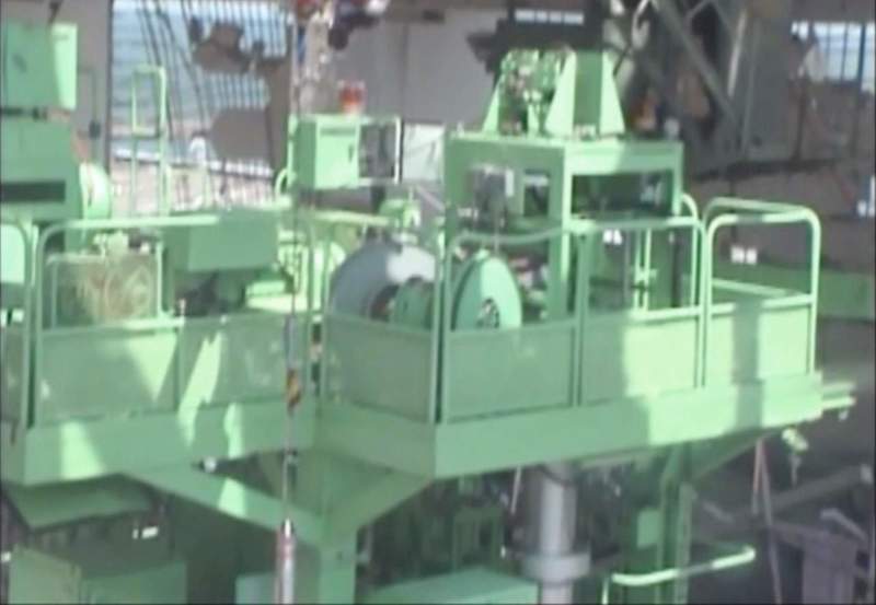

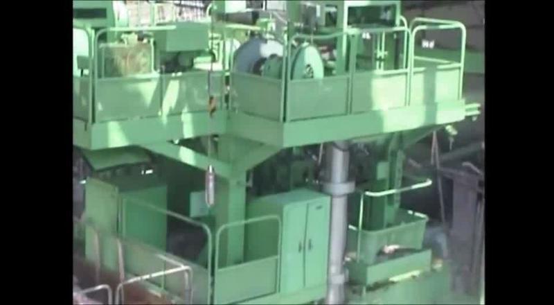

TCups said:
REGARDING A BALLISTIC FUEL HANDLING MACHINE
If there were fuel handling operations in progress and the quake hit, then power failed and the reactor scrammed. It seems plausible that the operators would put the fuel assembly they were handling back in a safe position (if the fuel handling machine could draw power from the backup diesel generators, otherwise not), then get the heck out of there to see what was going on. Think about it -- working up there above the SPF and a big quake hits.
Also, I have absolutely no first hand experience, but from the pictures, the part of the fuel handling machine that handles the fuel assemblies is not a cable or anything like it. It looks like a rigid vertical arm, probably hydraulic, and I would be willing to bet it was built to be very precise, hold the fuel rod assemblies very securely, and put them in exactly the right spot.
If the blast resulted in the same initial trajectory and velocity of the FHM and attached fuel rod assembly, then, the point of impact would be about the same, I should think.
How about it Astronuc? What are the actual mechanics of a FHM and how does it attach to and secure a fuel rod assembly for movement?
Offsite power wasn't lost until the tsunami about an hour after the earthquake. The plant upset (SCRAM) would have halted any fuel moves in progress. It only takes a few minutes to put a fuel bundle back into the spent fuel pool.
The fuel handling machine has a mast with a gripping "grapple" at the lower end. The mast is telescoping for vertical movement. The FHM is mounted on a trasverse for east west and noth south movement between the spent fuel pool and the reactor cavity. It can be positioned directly over any pool or reactor fuel site.
