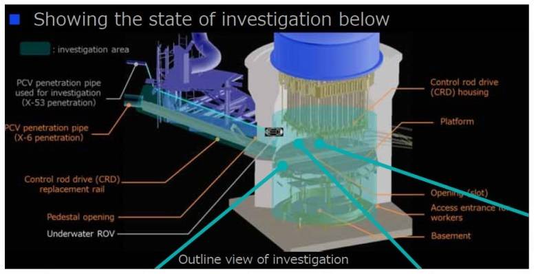

Investigation of PCV of Unit 3 - Quick report, photos and movie from Tepco/IRID/Toshiba
http://www.tepco.co.jp/nu/fukushima-np/handouts/2017/images2/handouts_170719_08-j.pdf
http://photo.tepco.co.jp/date/2017/201707-j/170719-01j.html
Some damage was found in structures inside the pedestal. A few pieces of material from CRD housings were seen fallen inside the pedestal. It was not possible to assess the state of the grating above. When the robot approached structures under water a certain murkiness appeared as deposits were stirred. The images taken today will be used to decide on the second phase of the investigation, scheduled for 7/21.

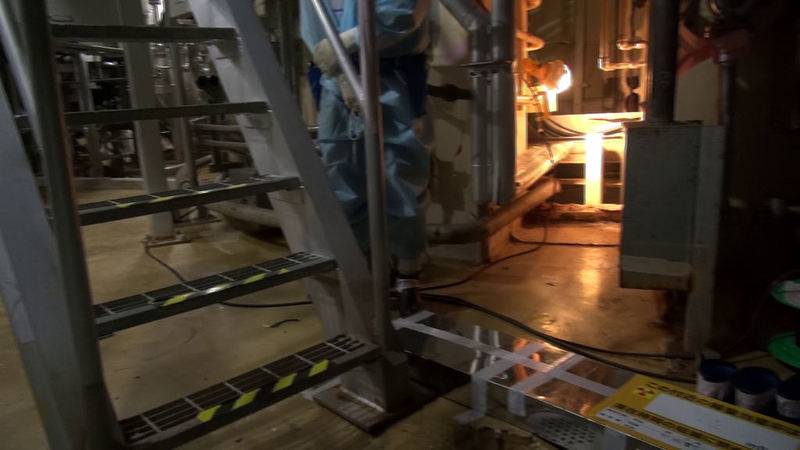

  • #1,297
Quick report again (only in Japanese for now) about the Unit 3 PCV investigation of July 21st:
http://www.tepco.co.jp/nu/fukushima-np/handouts/2017/images2/handouts_170721_09-j.pdf
Photos: http://photo.tepco.co.jp/date/2017/201707-j/170721-01j.html
They sent the robot inside the pedestal and took some images.
They identified "what appears like once molten mass(es), now solidified", as well as "fallen objects". (Separately on NHK TV I saw a Tepco representative stating that these solidified icicle-like masses have a high probability of being "molten fuel and various parts", which mixed and later solidified.)
Same as in the first day, they saw damaged structures and fallen support fittings of CRD-housings.
During today's operations too they couldn't see/confirm the grating platform where it should have been.
Tomorrow they will try to go down into the basement of the pedestal. Due to many obstacles and fallen objects they think they might not be able to retrieve the robot.

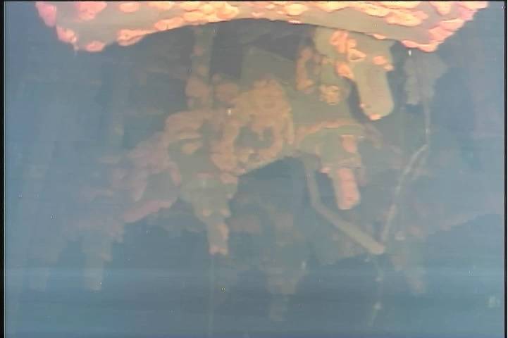

It has certainly made the news.
http://abcnews.go.com/Technology/wireStory/melted-fuel-time-fukushima-plant-48769520
It is difficult to know at what one is looking. The CRD housings are clear in some pictures (looking up from underneath), but in others it's not clear if one is looking up or down. Certainly there is a lot of corrosion and corrosion products. If there were chunks of molten fuel below the pressure vessel, then I would expect somewhere there should be a relatively large hole in the pressure vessel.

Far more interesting than expected.
First and foremost; the water level. The water level in Unit 3 is remarkably high. The probe results from the other 2 units show water levels much, much lower.
At 1:40 in the video we see the probe swimming close to submerged control rod drives.
Knowing that the CRD bottom ends are located at the top of the pedestal and that the bottom of the pedestal is openly connected to the outer pvc area, that means the entire unit 3 Primary Containment 'light bulb', must be flooded to an amazing level (Similar to the light blue area below but also including the outer area).
Considering that the unit building is above the water table and sea level, they must be pumping water into keep it flooded.
The second interesting thing is the structure of the deposited fuel melt. Anybody experienced in lava or melt flows would be able to say whether these globular formations were formed in air or in water, i.e. did the fuel melt burn through the reactor onto a dry floor where it could burrow further or was it quenched as it entered an already flooded containment.
Lastly, muon results. It will be interesting to see when they are released, how they match up with what appears to be visible fuel deposits in the Unit 3 pedestal area. That could give some information as far as the lack of results from the scans on units 1 and 2 i.e. is the fuel in units 1 and 2 higher or lower etc.
Unit 3 being so heavily damaged but still holding that much water is definitely the most surprising thing to see though.

Hiddencamper said:
unit 3 was depressurized so it did not have a hot debris ejection.
Latest results and images seem to indicate Unit 3 did in fact sustain a substantial hot debris ejection.
Going by the definition of:
"an explosion through the bottom of the reactor [where nuclear] material scatters all across the basemat of the containment liner below the bottom of the reactor. If a core catcher was installed when the plant was built, the material will spread across the core catcher, and will not be able to eat through the concrete at the bottom of the containment. If there wasnt, it could potentially undergo a reaction with the concrete for a while, where it can eat through the containment basemat. The whole time this is occurring, if it is not cooled and water is not injected to the containment, then the containment will start to heat up, overpressurize, crack, and leak radioactive material directly outside." - HiddencamperTepco engineers and the new images seem to be suggesting this is exactly what happened. We know there was no "core catcher", which is why I raise the point about whether the pedestal area was flooded at the time the core ejected. Depending on how deep into the concrete the fuel ate and how damaged the basemat was by this and the earthquake explosions is very relevant. If the basemat is no longer water tight and the building is flooded to a height of 30 feet above sea level or so, there must be a lot of water flowing past the fuel into the environment. That would explain the groundwater contamination issues at the site.
Again, whether this new found apparent fuel will match up with the muon scans and what that says about the negative results on 1 and 2 could have a lot to say about fuel locations and depths over there too. Very interesting time and I'm glad TEPCO is sharing so much information
I see at least some CRD mechanisms still in place
which infers not gross vessel failure
so i doubt there was any significant 'ejection'though a smaller drip is sure plausible
which into water would cause a steam explosion likely scattering the fuel.
When they find the actual fuel its physical arrangement will give more insight to what went on that morning.
