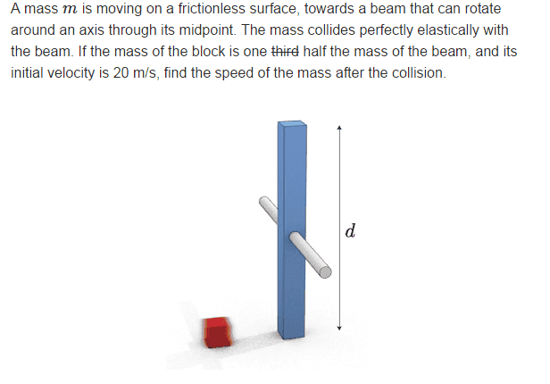

goonking
434
KEi = KEf
since it is perfectly elastic, kinetic energy before = kinetic energy after
(1/2) (m) (20m/s^2) = (1/2) (2m) (VBeamf^2) + (1/2) (m) (VBlockf^2)
is this the right approach? [/B]

Not quite. The beam can only rotate about the axis. What is its kinetic energy?
(1/2) (I) (ω^2) ?
goonking said:
(1/2) (I) (ω^2) ?
Yes. And you need one more equation. What else is conserved?
i have no idea, momentum?
Momentum is conserved when translation is involved. But the beam can not translate. What can be conserved?
I can't think of anything else besides momentum and kinetic energy. any hints?
For rotation, you have quantities analogous to translational ones. For position, it is the angle of rotation. For velocity, it is angular velocity. For mass, it is moment of inertia. What do you have for momentum?
angular momentum?
but if the initial angular momentum is 0, then the final has to be 0 too? since it was at rest
The angular momentum of the beam is zero, but the little mass has initial and final angular momentums with respect to the axis. How is the angular momentum defined for a point-like body, moving in the plane normal to an axis, traveling with velocity v, at distance D from an axis?

yes. What is r in this problem?
distance traveled before the block hit the beam? I have no idea
No, it is the distance of the line of track of the little mass from the axis of rotation. It is the same as the distance from the axis of the point where the small mass hits the beam .

Yes. Now you can write the equation for conservation of angular momentum.
i don't understand the use of this equation here.
m vi D/2 = m vf D/2 ?
The beam also has got angular momentum, you need to include it.

m vi D/2 = (m vf D/2) + ( I ω)
Yes, it is. You know the expression for the moment of inertia for the beam. And you have the equation for the energies.
Eliminate ω and solve for vf.

what is the moment of inertia for the beam? isn't there a whole list of moment of inertia for each shape?
You can use the formula valid for a thin rod of length D wit respect of the centre.

hmm, i didn't know you could do that, since the beam doesn't look like a thin rod.
anyways, it is 1/12*M* L^2
L being D/2 correct?
No the length L is D.
It does not look like a thin rod, but nothing is given about its width.

so basically, we have 2 equations.
the kinetic energy and the angular momentum.
do we equate them?
You can not equate angular momentum with energy. You have a system of two equations for the unknowns, final velocity vf and angular velocity ω. Solve.
