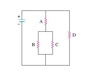

The circuit shown below consists of four different resistors and a battery. You don't know the strength of the battery or the value any of the four resistances.
Select the expressions that will be equal to the voltage of the battery in the circuit, where [tex]V_{A}[/tex], for example, is the potential drop across resistor A.

So I know Kirchhoff's voltage rule for closed circuit loops states that the voltage in a closed circuit is 0.
I think that the answer would be[tex]V_{A} + V_{B} + V_{C} + V_{D}[/tex].
am I right?

Well, according to Kirchhoff's voltage rule for closed circuit loops, V_B and V_C should be 0, so if that's true then it should be V_A+V_D since the voltage has been split into the two paths
Voltage doesn't split like that. If Vb and Vc were not there, then the voltage drop across Va and Vd would be the same(that'd driven by the voltage source), and your answer
By saying that Vb and Vc = 0, well, you're basically saying they're just more wire, not resistors, and that Va is hooked to the plus terminal of the battery, as is Vd, and both other ends connect directly to the negative terminal, and your answer would be either Va or Vd
Lets start over here. You said you know that Kirchoff's voltage law (KVL) states that the sum of all voltages in a closed loop is equal to zero. Simply apply this law to one of the closed loops in your circuit. In the circuit you have drawn above there are 3 loops that go to ground, 2 of these 3 loops can directly provide you with the voltage you seek namely the voltage across the battery, let's call it V_bat.
I will apply KVL to one of the 3 loops as an example in a clockwise direction:
-V_bat+V_A+V_B=0
rearranging terms...
V_bat=V_A+V_B
I hope this helps you, there is also another solution to this problem that I will leave for you to figure out. The same priciples apply.

I don't understand this, I thought A,B,C, & D summed together would equal the voltage in the battery because there are parallel components in the figure, so the voltage splits unequally between A and D and splits equally between B & C.
A loop is a single, closed, non bifurcating, non self-crossing path through the circuit. Can you show us how you would draw the loop A,B,C,D?
A corollary of the loop law is that if you pick any two distinct points (call them 1 and 2) along the path of the loop (that is, they are not the same node), then the loop is divided into two distinct paths from one point to the other, and the sum of the voltages for both paths from point 1 to point 2 must be equal.
In the case of this circuit, if you pick the two points to be at the two battery leads, then there are precisely three paths through the circuit that can form the "other path" of the closed loop. You should be able to identify them.

Ok, I got it now. Thank you :)
