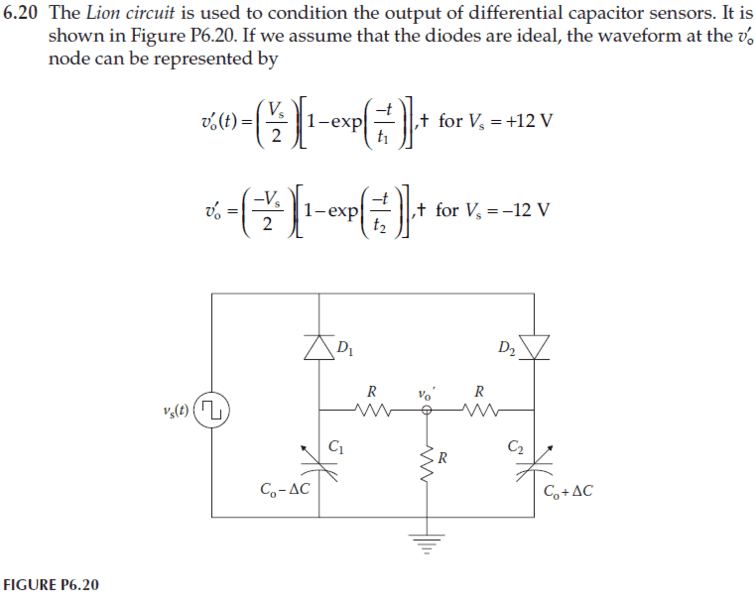

Textbook figure P6.20 showing the Lion circuit: a square-wave source vs(t) feeding two diodes D1 and D2, capacitors C1 (C0 - ΔC) and C2 (C0 + ΔC), two resistors R, and output node vo' to ground, plus two printed equations for vo' at Vs = +12 V and Vs = -12 V.
Printed problem text: where C1 = C0 - ΔC, C2 = C0 + ΔC, τ1 = C1R(3/2), and τ2 = C2R(3/2); assume τ1 and τ2 >> T/2 of the input square wave vs(t). Part A asks for an algebraic expression for the average v'o(t) in the SS, with R = 10^6 Ω, C0 = 30 pF, T = 10^-5 s, Vs = 12 Vpk, and the sensitivity in DC volts per ΔC/C0.

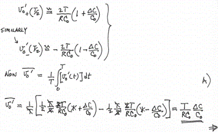

Handwritten derivation of averaged output voltage: V0'+(T/2) and V0'-(T/2) expressions with ΔC/C0 terms, integrated over one period to give mean V0' equal to T/(R C0) times ΔC/C0.

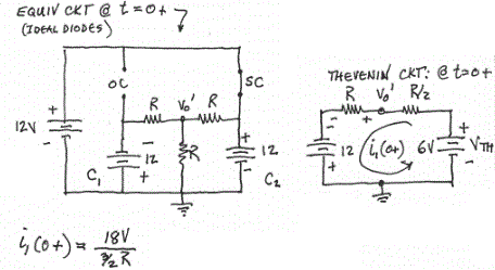

Handwritten equivalent circuit at t=0+ with ideal diodes, showing a 12V source, capacitors C1 and C2, resistors R, an open switch and short switch, and a Thevenin equivalent circuit with 12V, 6V, R/2 and VTH, plus the expression i1(0+) = 18V/(R/2 R).

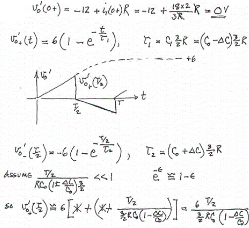

Handwritten equation: v_o'(0+) = -12 + i_L(0+)R = -12 + (18 x 2 / 3R) R = 0V, with the final 0V circled.
Unsure about this KVL (above).

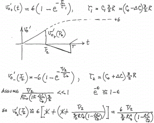

Handwritten derivation of a circuit's output voltage after switching, with exponential expressions for V0 and time constants tau1 and tau2 in terms of C0, delta C, R, and a small-approximation step using e^-e ≈ 1 - e, plus a sketched triangular waveform against time t.
Handwritten derivation of average output voltage V0' = (Vs/12)(1/(RC0))(ΔC/C0) = (12V/12)(10^-5/(10^6 x 30 x 10^-12))(ΔC/C0), then V0' = 0.333 ΔC/C0 = ΔC/(3C0), labelled Sensitivity.
For the last sensitivity part, equations be falling out of the sky...
