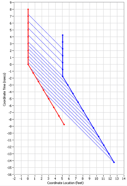

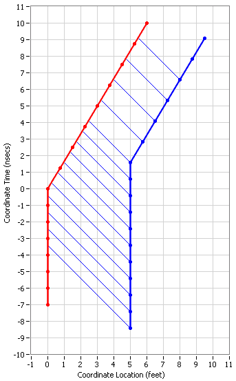

I have made a couple spacetime diagrams which might depict the scenario you have in mind. Here is the first one that shows the Inertial Reference Frame (IRF) in which the spaceship was at rest prior to its acceleration. I have shown the lamp as the thick red line with dots marking equal intervals of its Proper Time when it sends out light signals to you, shown in blue towards the front of the spaceship. The acceleration of the spaceship is unrealistic but intended only to show the Doppler shifts that you asked about.
Prior to your acceleration, you receive the light signals at the same rate that they were sent and so there is no Doppler shift. Some time after your acceleration, you are also receiving the light signals at the same rate that they were sent even though both the lamp and you are time dilated in this IRF. Since I have set the final speed of the spaceship to be 0.6c in this IRF, the gamma factor is 1.25 and you can see that the Proper Time dots for both you and the lamp are spaced out by 1.25 so that in 5 nanoseconds of Coordinate Time, the Proper Time has advanced by only 4 nanoseconds.
But during the acceleration transient, you are receiving the light signals Doppler shifted by a factor of 0.5. Even though the lamp accelerated prior to you (in this IRF), you don't see the effect of that until some time later but you do immediately see the effect of your own acceleration as soon as it happens.
You also talked about an observer at rest in this IRF. In order to depict what he sees, we would have to drawn in light signals from each event of interest to wherever you want him to be (assuming that he is located along the same axis as the spaceship's acceleration). You have indicated that he sees the spaceship moving away which implies that he would be located at some negative Coordinate Location. You could have also placed him at some positive Coordinate Location and although he would see things differently, he could still reconstruct the same IRF (after it was all over and by using radar methods). But, in my opinion, it is far easier to forget about observers at rest in an IRF and just talk about the worldlines and events in the IRF in which case, we become the observers and we don't have to worry about light propagation time. Let me show you what I mean.
Let's transform the entire scenario depicted in the above IRF into the IRF in which the spaceship is at rest after the acceleration:
First, I want you to notice that there is no inertial observer that is at rest in this IRF. But we can observe this IRF with no problem.
Next we want to note that in this IRF you accelerate before the lamp does and yet you continue to see the signals from the lamp exactly the same as you did in the first IRF, that is, you see them coming in with no Doppler shift prior to and after the acceleration transient but during the acceleration transient there is a Doppler shift of 0.5, even though in this IRF the Time Dilation factors for you and the lamp happen in the opposite order.
Now if you want, you can add another observer at rest anywhere in this IRF and show how he can construct this IRF diagram using radar techniques. You can also show an inertial observer moving in this IRF diagram (such as the one who was at rest in the first IRF) and show how he can construct a diagram for his own rest frame. Furthermore, you can use the same radar technique to show how you, accelerating on the spaceship can construct a diagram for a non-inertial reference frame in which you remain at rest.

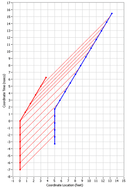

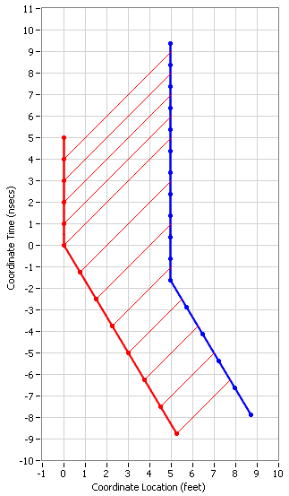

In my previous post #20, I showed you a scenario in which you were near the front of the spaceship and you saw the color of the lamp near the rear of the spaceship red shifted during the acceleration phase. Now I want to show you that you will see the color blue shifted during the acceleration phase if you are riding towards the rear of the spaceship looking at a lamp near the front of the spaceship. In this spacetime diagram for your initial rest frame you are depicted in red and the lamp is depicted in blue:
As you can see, prior to your acceleration, you see the light signals from the lamp with no Doppler shift but as soon as you accelerate to a new speed you instantly start seeing the light signals Doppler (blue) shifted to twice there normal rate. This lasts until the signals corresponding to the acceleration of the lamp reach you at which point, the Doppler shift goes to zero and you once again see the light signals coming in at their normal rate.
And here is the spacetime diagram showing your final rest frame moving at 0.6c with respect to the first one:
Once again, you can see that a different Inertial Reference Frame has no bearing on the Doppler signals that you see (or that any other observer anywhere else sees, for that matter).
