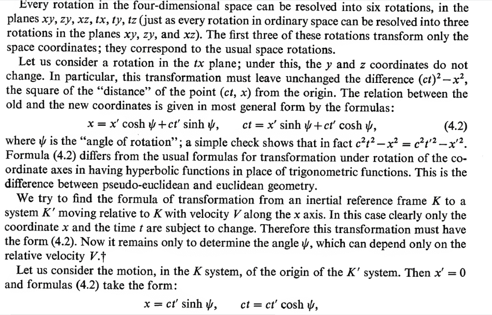

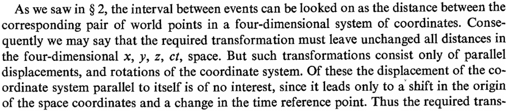

In his book, Landau derives the Lorentz transformations using the invariance of the interval, and I have some questions about it that I would like to clarify
1. What is a parallel displacement of a coordinate system?
Does it refer to moving along any axis?
I don't see how any arbitrary translation of the origin will change the interval between any two events
2. Does this assume that the origins of the two coordinate systems coincide?
The interval between two events is ##s^2=c^2(t_2-t_1)^2-(x_2-x_1)^2##
For this to reduce to ##s = c^2t^2-x^2## this requires that ##x_1## is zero. However, considering that ##x_1## and ##t_1## are the coordinates of the origin, this would imply that in his equations he has assumed that the origin of both systems coincide.
While I understand that this is correct at some instant, would this not become inaccurate as time passes and the origin of one coordinate system moves away?
It appears to be any translation - so excludes a translation and scaling (since ticks on some axes wouldn't move in parallel lines).
I think so, yes. But we may freely translate our coordinate systems so that this is true.
This is the origin of a coordinate system in spacetime - it's a specified place and time. It doesn't move, any more than "in my back garden at 11am last Tuesday" moves.
It refers to just adding arbitrary constants to each coordinate so, in effect, a translation. His point is exactly that it is trivial that such translations leave the interval invariant so he will not discuss that explicitly.

Yes, but in a galilean transformation we consider that the origin is translating spatially, so why should we consider the origin to always coincide in a lorentz transformation?
Galilean transformations preserve spatial distances, but that doesn't mean that galilean transformations are spatial rotations.
By analogy, why are spacetime transformations different?
Because the full group that include space snd time translations is called Poincaré transformations. Normally only Lorentz transformations are considered because translations do not add any conceptual difficulty. It is trivial that they also conserve the spacetime interval.
