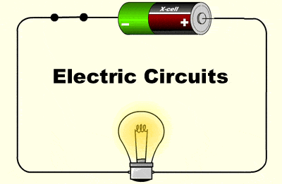

My apology for the lacking info, consider this simple presentation of what I meant (see figure)
How much proportions of heat and light are being generated from the total dissipated energy of the load?
Is there a model which predicts how much proportions of heat is being generated and proportions light with relation to an intrinsic property of a material?

It mainly depends on the geometry of the wire in the light bulb and its resistance. The material does not matter much for typical light bulbs (as long as it does not melt, obviously). It does matter if you care about the lifetime, but that is a different question.
The emission is roughly a black-body spectrum, and this spectrum depends on temperature only. Higher temperatures give a higher fraction of visible light relative to heat (infrared light).
