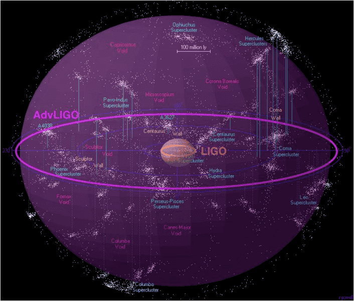

It was worth posting again, my favorite:
I wish I could get it on google maps and point it the way I'm facing...
If I remember correctly, LIGO does not detect changes in the wavelength of its beams directly but by inferring it from how far out of phase two different lasers become.
When they leave, the beams are perfectly in sync, when they come back, any deviation from that is from the fluidity of spacetime.
This is because it spent less time in one arm than the other because it got slightly longer or shorter as the wave passed. That’s why it can be detected from within the wave itself.
