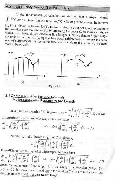

i'm not sure what is line integral...
Does it mean total length of line under the curve?

If f(x,y,z) = 1, then the line integral of this function over the curve C will give the arc length between a and b. If f(x,y,z) is some other function, this won't be the case.

Then, how about s( in the first photo in first post) only ? It represents the total length of curve?

No. s is the cumulative distance along the curve, starting from a specified location.
What they are doing here is defining the locus of points along a curve in space by specifying each of the three coordinates x, y, and z as a continuous parametric function of a parameter t.
x = x(t)
y = y(t)
z = z (t)
Specifying a value for t determines the coordinates of any particular point along the curve.
Consider two closely neighboring points along the curve that are situated at t and at t + dt. The differences in the x, y, and z coordinates of these two points are given by:
##dx = x(t+dt)-x(t)=\frac{dx}{dt}dt##
##dy = y(t+dt)-y(t)=\frac{dy}{dt}dt##
##dz = z(t+dt)-z(t)=\frac{dz}{dt}dt##
The spatial distance ds between the two neighboring points along the curve is given by the Pythagorean Theorem:
$$(ds)^2=(dx)^2+(dy)^2+(dz)^2=\left[\left(\frac{dx}{dt}\right)^2+\left(\frac{dy}{dt}\right)^2+\left(\frac{dz}{dt}\right)^2\right](dt^2)$$
If you want to find the contour integral of a function f(x,y,z) between two points along the space curve, you want to be integrating f ds. This is the same as$$\int_{t_1}^{t_2}{f\left(x(t),y(t),z(t)\right)\sqrt{\left(\frac{dx}{dt}\right)^2+\left(\frac{dy}{dt}\right)^2+\left(\frac{dz}{dt}\right)^2}dt}$$
