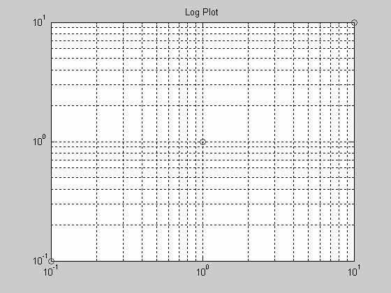

I am working on a homework for a programming class. We have to create a Logarithmic plot and add to it a marker when the program is running on the click of the mouse. That is NOT the problem :) , in fact, that's very simple!
My problem, however, is with the scale. When my plot is in linear scale it adds the marker right where it should. By that I mean that if I click on point (1,2) it adds my marker on (1,2). Now, when I switch to logarithmic scale, if I click on (0,0) it adds the marker on (1,1). If I click on values greater than 10, it adds the marker at the place where I clicked. But when my values are lower than 10, the marker is shifted to the right. How do I solve that problem? I already tried converting the values I get from my mouse-click event to logarithmic values and they are wrong. In fact I get negative numbers when the values are lower than 1; so the marker is shifted to the left. I am not good at all with log scales; so, please help me!

It's difficult to know what is happening without seeing your code. Some ideas:
The logarithm of 1 is 0, so when you click on (0,0) you are really clicking in (log 1, log 1). Anyway, you cannot have the poin (0,0) in a log scale, since log 0 = - infinity.
The logarithm of a number between 0 and 1 is negative.

About what you say, you're right and I had noticed that before. Now, my question is, how do I go from (log 1, log 1) to my linear numbers so that I can get the right position?
I just did a quick test to see what the event returns. As I click closer to 0, it results in a number sifted more and more to the right. I am only showing the x coordinate since the y have exactly the same results. Also, the resulting values are approximate since I did not zoom in close enough in the plot to click exactly on the number.
Click on Result
10 10
9 9.118812375
8 8.223735874
7 7.307858871
6 6.444623616
5 5.50047321
4 4.624704838
3 3.70626008
2 2.820675981
1 1.90761842
0 1.003834079
it looks like a function, I just don't know how to find it. I think that if I find it, I can solve my problem.

This is really weird. It is not a logarithmic function. if you call Y the vector of clicked points and X the vector of results, you obtain:
y = 1.1104x - 1.1234.
The problem is with your labelling. There is no point (0,0) in a log plot. If you must plot numbers that are less then 1, you should put your origin at (o.1, 0.1) or (0.01, 0.01). Remember that the distance between 0.1 and 1 is the same as from 1 and 10. See anex graph. That is what makes the linear relationship between clicked point and result skewed.
