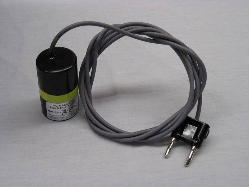

Are you working with DC magnetic fields or 60Hz AC magnetic fields? If AC, you can buy inexpensive probes that plug into your DVM to let you know what your field strength is throught the coil and surrounding area. Here is one that I've used in the past:
http://custommagneticshielding.magn...egories/evaluation-kits-meters-probes/ep-101a
Likes NMNXX
