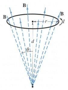

A circular loop of wire, of radius r, carries current I. It is placed in a magnetic field B whose straight lines seem to diverge from a point a distance d below the ring on its axis. (That is, the field makes an angle θ with the loop at all points, where tan(θ) = r/d.) Determine the force F on the loop. Express your answer in terms of the given quantities.
F = I*L*B*sinθ
Not sure how to approach this.
You should probably integrate it over the whole volume since dFb = I * dsXB (cross product), then the Fb =I* ∫dsXB. In this case ds will be dv - a small volume which I assume the volume of cone will be. (not sure, but maybe lighten your solution). If you consider only ds (surface) then from a triangle ds will be r/sinθ * cosθ.
∫r cosθ/sinθ dr
F = L * ( I × B ). So the forces will try to expand the loop, and will pull the loop downwards. So assuming that the given value of B is at the location of the wire, Fdown = I*L*B*sinθ.
L = 2πr.
Σ(radial forces) = 0

If you look at a piece of wire with the length dL, there will be an opposite piece of wire, dL, in the loop, pulled in the opposite horizontal direction. The sum of the horizontal forces = 0. The loop as a whole will not be pulled horizontally.
