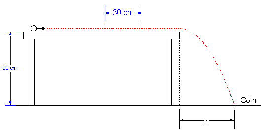

1. A student finds that it takes .20s for a ball to pass through photogates places 30cm apart on a level ramp. The end of the ramp is 92cm above the floor. Where should a coin be placed so that the ball strikes it directly on impact with the ground?
gneill said:
Yep, that's the picture I have! However, I have NO CLUE where to start it. Where does the 30cm come into play? I'm thinking find the time, then average velocity, to then both put into the ΔX=blah blah blah equation
You're GIVEN the time for it to pass between the photogates. No need to find it. If you know the time for the projectile to travel the 30 cm between the gates, what's its speed?
If you then have its speed, what are the formulas that describe its trajectory when it leaves the edge of the level surface?

This is how I did the problem-
H=1/2gt^2
.92m=1/2(9.8)t^2
T=.43s
V=ΔX/ΔT
30cm/.2s
V=1.5m
Then I plugged in both answers into:
ΔX=ViTf+1/2ATf^2
ΔX=1.5(.43)+1/2(0)tf^2
ΔX=.65m
Does this look right?
H=1/2gt^2
.92m=1/2(9.8)t^2
T=.43s
V=ΔX/ΔT
30cm/.2s
V=1.5m
ΔX=ViTf+1/2ATf^2
ΔX=.65m
Yep its right ... sorry for my above confusing post ... this problem was not in the language i am used to ...

Couple questions on the problem still-
1)First, why did I have the use the H=1/2gt^2 equation to get T=.43s? I think it has something to do with the horizontal and vertical relationship to each other? But if the problem gives me .2s already-what is that for?
2) Second, I used the average velocity equation, but how can the average velocity switch to being the Vi in the ΔX=ViTf+1/2ATf^2 equation? How does that work?

1)
when marble falls from table, in Y direction there is no initial velocity (right?) ... so for eqn:
y = uyt + 0.5 g t2 .. uy turns out to be 0
The 0.2 sec is used to calculate the speed of the ball before it starts falling. The 0.43 sec is the time it spends in midair. While it's free-falling, it also continues to move horizontally away from the table.
The initial speed of the ball was calculated on a level surface. What is the value of the horizontal component of gravity acting to speed up the ball over this path?
