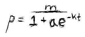

Apologies for not being clear enough yesterday, and not getting back until now. e is a constant on our calculators, stated as 2.718281828, and the problem is in the attachment,http://img14.exs.cx/my.php?loc=img14&image=fishpond0ux.jpg if I did it right.
The question:
(a) Given you stock the pond with 1000 fish initially, determine the value of a.
(b) How many years will it take for your pond to reach its carrying capacity?
The problem being, if a is a constant, what do we look at as the fresult of the population?

Would you mind telling us HOW, given only the information you gave (and the url you give do3es not have ANY problem, just a formula), you found that m= 53869? Assuming that you are given p= m / (1+ae-kt), there were 1000 fish "initially" and, if we assume that t is the time, in years, since the pond was initially stocked (you should have told us what "t" meant- just saying "t is time" isn't enough), then "initially", t= 0 p(0)= m/(1+a) = 53869 /(1+a)= 1000. Can you solve that for a?
As t gets larger and larger, e-kt approaches 0 so, yes, as t goes to infinity, p approaches m in the limit. Strictly speaking, p is never equal to m but, since p has to be an integer (it is the number of fish in the pond), for what value of t will p= m- 0.5= 53868.5?
That is, solve 53869/(1+ ae-.9t)= 53868.5 for t, using the value of a you got above.
t is time in years, sorry, and I solved a for the first part to be 52.869, and from what your saying, p doesn't stay the initial population, it changes as soon as t is greater than 0, therefore, I solve for t, with p equal to 52868.5 aaaand I'm just restating everything you just said, but in some way, that means I understand it. As for finding m, that was a whole other section of the assignment itself, involving estimation, trig, and a very skewed diagram. Regardless, thanks for the help.
