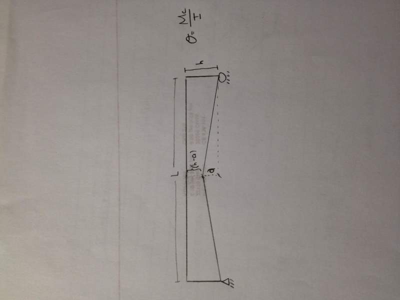

Bending moment HELP
Can anyone help me to figure out this one
I have no clue
Trying to find the bending moment of this beam
is related to bending moment in cracked beams
all I know is σ=Mc/I how do I approach this
Thanks
First of all, how is the beam loaded? You can't determine the BM unless you know the loading.
The beam is under 3 point loading

Also, your answer for 2c, shouldn't it relate to stress in the beam, and not the bending moment? The diagram looks correct but the numbers don't.
