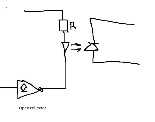

I have a drawing similar to that picture given to me to help me out. I've only just started this project so I've not got anything specific. Can you explain to me what's happening in that circuit?
That circuit shows an input LED that is driven by an external digital gate (with a current-limiting resistor), and a photodiode that will convert the light from the LED into a photocurrent.
Unless you need a really fast optocoupler, that's not the easiest way to go. It requires a current-to-voltage converter at the output. A much more practical version uses a phototransistor at the output, which only requires a pullup resistor to make a digital output signal. More like this...

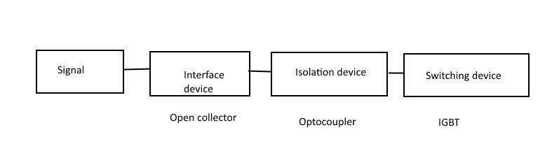

What I'm doing is building a switching device for a switched reluctance motor. I've just started so I'm not too sure what I'm doing but I know the basic devices I NEED.
Block diagram of a signal chain left to right: Signal, Interface device (labelled Open collector), Isolation device (labelled Optocoupler), Switching device (labelled IGBT).
That picture shows the basic way it'll be connected up. I know for sure I need all these devices, but put VERY SIMPLY, why do I need that open collector there? Why can't I just remove the open collector altogether?

I don't know of any reason for an open collector stage before the optocoupler. In fact, it would appear to be bad design practice on the face of it. It will slow down the interface -- a simple digital buffer gate can be used if the uC does not have enough drive capability for the LED side of the optocoupler.
Is there a more complete problem statement that you can share with us?
Actually, which direction is the signal propagating in that diagram? I'd assumed left-to-right to drive the IGBT. But if the signal is propagating right-to-left as a monitoring signal fed back to the uC, then the diagram may only be saying that the output of the optocoupler on the left needs to be treated as an open collector signal going to the uC on the left, and hence you need the resistor pullup to 3.3V or 5V. Could that be what they are trying to show?

Hello Nothing -
Since you are using an IGBT and Not a MOSFET you are probably not dealing with a 1-2 Amp / low voltage switching case correct? In power electronics - it is very common to add a buffer between the controller and the opto; the general reason is noise immunity but there are few others. The controller may be mounted separate from the power electronics ( Switching devices and drivers - etc) -- and the buffer, opto (IGBT driver) and IGBTs are all assembled close to one another. Since the IGBT switching generates a lot of EMI, you want the signal from the controller to the power electronics to stay "clean".
Did they also say to use a separate power supply for the controller and the Buffer/ Opto? This can also allow a level shift between the two. Or the link from the uC to the Buffer may be at a higher voltage - also for noise immunity- requiring a level shift to the opto - by always putting (or expecting to put) a buffer there, you will be more successful and have fewer problems.
Is it possible you are being told to do this as a "best practice"?
As such - from a pure electrical circuit standpoint, yes the uC can run the opto, but in practice this is not ideal for this case.
An open collector driver might be used where the microcontroller runs on a low-power regulator, or where a low supply voltage is used, the opto-isolator is then run on a higher voltage or on the unregulated supply.
