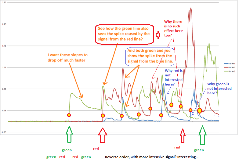

@davidwinth Try going back to one sensor per DAQ channel to see how that affects the signal interference. From you image in post 22 (https://www.physicsforums.com/threa...-front-of-a-plasma.942881/page-2#post-5966324), the DAQ sampling rate seems high enough that you could estimate the peak locations fairly accurately.
Rive said:
The second, is to physically remove every 'sensor' from the setup, except two. Then with that two remaining sensor repeat the experiment and check whether what the sensors seems to sense is real (in this case it'll be sensitive to the arrangement of sensors).
This was done per posts 21 thru 30-something, and none of us properly followed thru. :frown:
Rive said:
More like some resonant or reflecting behavior associated with the flame front.
Re-reading some earlier posts, combined with more recent report results, there is a lot to support that. Especially if the fuel is distributed over the length of the sensing area, whether or not it is done explicitly or as flamefront in an expanding gas flow. For instance, assume the experiment is done in an enclosed space such as a gun barrel. I can see how pressure waves could increase conductivity at earlier sensors, and also how gas flow could induce signals at later sensors just before the flame-front arrives. See the image in post #18.
davidwinth said:
The other supporting info is that the experiment lasts about 15ms with the speed of sound around 1100 ft/s and the OP stateing that the sensor wiring is about 8 feet long.
All these seem to point to a highly flammable fuel, probably a gas, that is not a high explosive (i.e. flame front is not supersonic), in an enclosed space. It could also be the unstated reason the OP is resisting the test of a fan blowing across the experiment to gather further data.
If the above conjectures are indeed facts, then the signals are very likely to be real in the sense that what is being measured is the plasma density at the gaps.

Some signals are too close to each other, so some kind of coupling on the side of the electronics is likely to be present - but it is just not consistent.
Ps.: just noticed that blue also part of the same forward-and-backward pattern...
