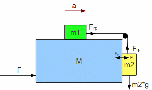

I'm trying to solve this in two ways, and i keep getting different solutions. I need to find the force by which M should be pushed for m1 and m2 stand still (compared tom M). There is no friction between anything.
First solution:
F_{rp} = m_2 \cdot g \: \: \: F_{rp} = m_1 \cdot a \: \: \Rightarrow a = \frac{m_2}{m_1} g <br />
<br /> F = (M + m_1 + m_2) \cdot a = (M + m_1 + m_2) \cdot \frac{m_2}{m_1} g<br />
So in this solution, I'v observed all the objects as a system, so that's how i got the F=m_total * a.
Second solution:
F_{rp} = m_2 \cdot g \\\\\\\ F_{rp} = m_1 \cdot a \: \: \Rightarrow a = \frac{m_2}{m_1} g
<br /> m_2 \cdot a = F_p
<br /> F - F_p = a \cdot M \: \: \Rightarrow F = a \cdot (M+m_2)<br />
I've done a step by step decomposition of all forces, but I'm missing the influence of m1.
What am I missing here?
for second solution:
F - Fp = a . ( M + m1)
Then the final answer will appear as F = (M + m1 + m2) . a
Why so?
If I'm observing the forces diagram for the mass M. There is not a force m1*a having an influence on it.
Could you explain please?
hi pinsky! :smile:
essentially, you're asking is F = (M + m1 + m2)a, or is it only F = (M + m2)a ?
you're thinking that there's no horizontal force between m1 (the top block) and M-plus-m2, the force F is pushing M and m2 but isn't pushing m1, and so why should m1 be included in the F = ma for M-plus-m2 ?
but you're ignoring the forces at the pulley … if the pulley was mounted on a spring, the rope would pull it diagonally down … basically, there's both a horizontal force and a vertical force at the pulley, each of strength Frp, and that horizontal force is an external force on M-plus-m2, making the M equation (F - Frp - Fp) = (M + m2)a :wink:
YES!
Thank you!
I've failed to see the pulley can be considered as a part of M, and that is how m1 influences M.
[SOLVED]
