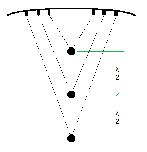

Conceptually these issues wouldn't matter much to GW detection of what I've been calling "Ligo in space", because there's no problem with the size of the frame for that problem, most especially if you orient the detector optimally. Then it's easy to talk about how the test masses move relative to the beam tube, because we can approximate it in the familiar context of a rigid frame.

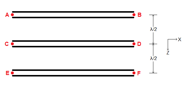

How about three copies of LIGO-in-space separated in the z direction by λ/2, would it be possible to say how that would behave? I've attached a sketch showing three tubes as black line pairs with red test masses (not to scale, λ≈2000km, tube length=4km).
Each tube individually, with its pair of masses, should be within a "pancake" region. In that view, I think the associated tubes would stretch and shrink, equivalent to the masses moving relative to the tube ends in the more usual representation. Since the tubes containing masses A-B and E-F are a wavelength apart, I am hoping we can define a congruence in which all four are always at rest and the distances A-E and B-F are also constant.
The question then is what happens to masses C and D and their associated tube? I think there should be a third "pancake region" covering them so, within that, the relative motion of the masses and tube should be as for the other two regions (just 180 degrees later), but is your calculation able to say how those two masses move relative to the congruence in which the other four are always at rest?
P.s. I'm also assuming we are simplifying by calculating for a constant wave frequency whereas the LIGO detection swept from a wavelength greater than the diameter of the Earth to 3 times smaller in less than 20ms, and that we are just working with plane waves.
My gut reaction is that you could create a different congruence for each tube in the stack, but they would be slightly different, having different simultaneity conventions. So you wouldn't have a coherent picture of the whole stack sharing a single, common, convention of simultaneity.

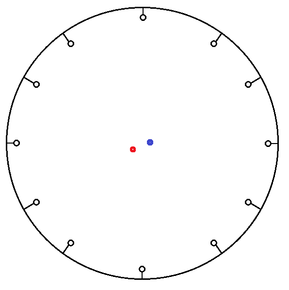

No, that part is not a concern for me, the usual calculations work fine. What I am looking at is the motion realtive to the Earth frame. Since the material response of that is too complex to work through, I'm looking instead at the motion of one LIGO-in-space as you describe it relative to two others, each half a wavelength away. It is the common motion of the C-D pair relative to the others rather than that of D relative to C that I'm trying to quantify but only at a very crude level.

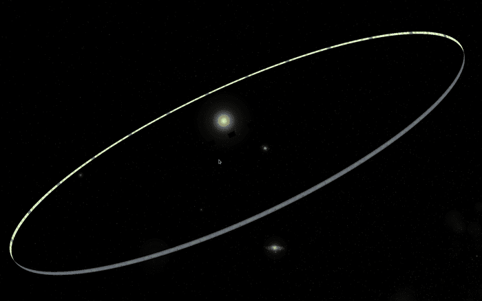

I've been revising the videos I posted before to try to visualise the transverse traceless approach in terms of non-moving test masses and a variable speed of light which, if I've followed your comments, is equivalent to the more conventional combination of moving masses and isotropic speed (i.e. both result in the same variation of phase at the photodiode).
I'll link the new videos but the descriptions are very crude at the moment:

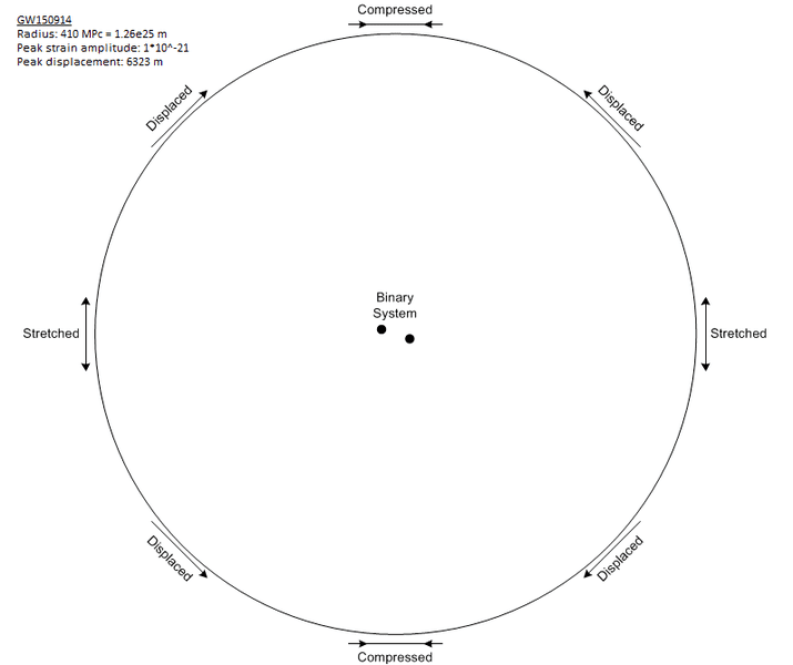

What I was trying to do was to represent the effect of GW on a surface which is a sphere round the source in a manner similar to depicting the motion of surface ocean currents on the Earth by drawing the motion of freely-moving floats on a globe while ignoring any bobbing up and down, so there is no attempt to map a sphere onto a plane. I could do this physically by drawing some sort of vector displacement field on a beach ball but a 3D animation should do it just as well. What I had read about gravitational waves before I started this was that they were transverse with no component in the direction of propagation (which I took to mean the radial direction when thinking in spherical coordinates centred on the source provided you are far enough away). Dropping any radial motion seemed therefore not to be a problem (but pervect's discovery of a z component complicates that).
That was all looking fine until I thought about a second identical sphere half a GW wavelength closer to the source. To put that in terms of the analogy, thinking about a similar map of currents at a fixed depth (again over the whole surface of the globe) and what I found is that comparing surface current with the current at depth gives a stupid answer. In GR terms though, I'm sure the problem isn't real, it's an artefact arising from my bad choice of coordinates so now I'm trying a different representation based on your suggestion of the transverse traceless approach. I just want to be sure I'm not "squeezing the balloon" in the sense of resolving one problem but creating another in some other aspect. To do that, I only need reasonable confidence that the common motion (not the measured differential effect) of the C-D pair of masses in my diagram is less than the few mm of compliance over which the suspension provides isolation.
My reluctance to go into details on the artefact is because I don't want crackpots taken my post out of context. Contact me privately if you want that aspect.
