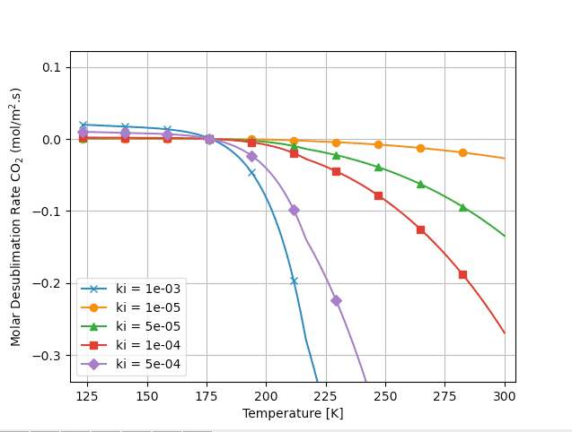

Hi Chet, looking further into the CO2 desublimation rate function, these are plots of temperature versus sublimation pressure (the gas-solid curve), and then temperature versus desublimation rate for a range of ##k_i## values, and ##y_{CO2}## = 0.2 (as it is in Tuinier et al).
Note that for the sublimation pressure curve, for temperature values above the triple point temperature (216K), i've used the liquid-vapour curve. Is there an alternative here? We could possibly say: if T is less than the triple point temperature, use the sublimation pressure curve, if T is greater than the triple point temeprature, let sublimation pressure = some large number?
No. You should be using the actual curve, although there is melting at the triple point (along with a latent heat effect) and, above the triple point, you should more properly be using the liquid vapor pressure.
Note that, at the triple point, the equilibrium vapor pressure is 5 bars, and at the critical point, the equilibrium vapor pressure is 74 bars.
Please plot the equilibrium vapor pressure on a logarithmic scale.

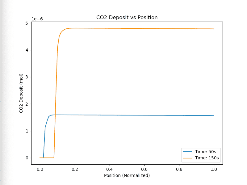

casualguitar said:
My apologies for the long-winded posts (my head is a bit fried!). The first plot below is completely at odds with the second one is it not? These plots are from the same simulation
What happened to evaporation of the deposits? I assume these values are in each tank?

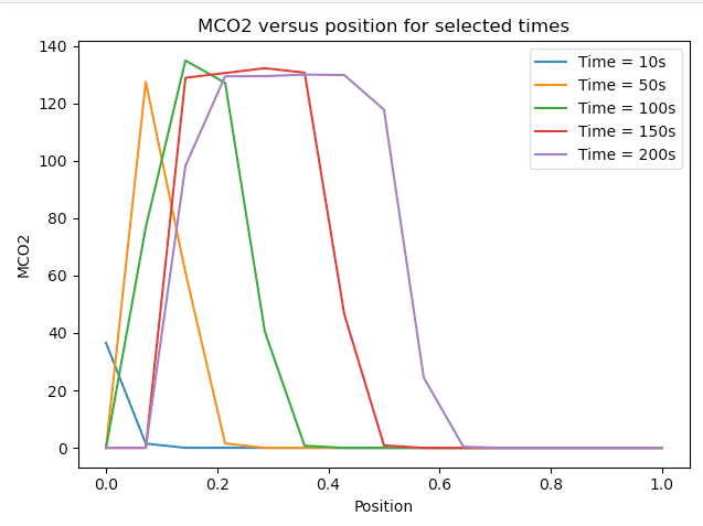

casualguitar said:
Hi Chet,
Output is looking better now. Only issue really is that we're producing a lot more solid CO2. The profiles look ok though.
I reverted back to an older approach we had, where we used something like their "fudge factor". I also put in the previous correlation for ##k_{CO2}##.
The fudge factor looks like this and only applies for sublimation (not desublimation):
if ##P*y_{CO2}## < ##P_{sub,CO2}##:
##M_{CO2}''## = ##M_{CO2}''##*##(\frac{M_{CO2}}{M_{CO2}+0.1})##
Tuinier uses 0.1 as their fudge factor. I'm using 0.1 also currently. We previously also discussed converting this 0.1 to a value suitable for us (different units), like this:
factor = 0.1*1000*A_C*dz/mW_CO2
As we're now calculating ##k_{CO2}##, we can no longer use this as a tuning parameter, unless I'm wrong. I'm wondering if we can instead use this fudge factor to tune the amount of CO2 produced?
Here's the output from the above. Note the output is a bit rough looking because I have used n=15. The the simulation takes a lot longer to run now so I'll increase this again once we're happy with the output:

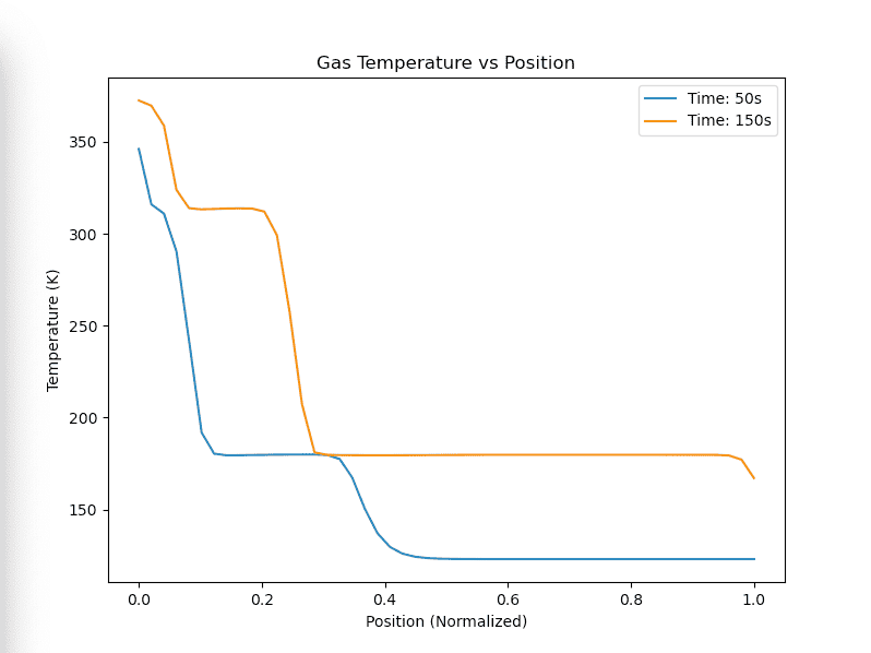

Gas temperature profile shows the constant temperature zone:

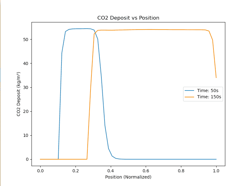

The amount of CO2 on the bed in kg/m3. Tuinier et al had values closer to 50kg/m3 for 50s and 150s:

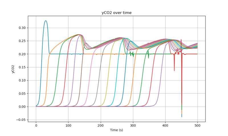

Lastly, ##y_{CO2}## for each position. Each position does level out at 0.2 which is the inlet concentration. There is a bit of fluctuation but this is possibly down to the sublimation process (I'll check this):
If this looks ok to you, do you think it is reasonable to use the "factor" to tune the amount of CO2 on the bed to Tuinier et al?
EDIT: If I take out the fudge factor and run it, the output looks like it did before (incorrect). I didn't think the fudge factor would have such an impact!
What the fudge factor does is prevent M from going negative. The amount of CO2 on the bed should always be positive.
I'm concerned about those much higher depositions of CO2 per unit area than the comparison calculation.

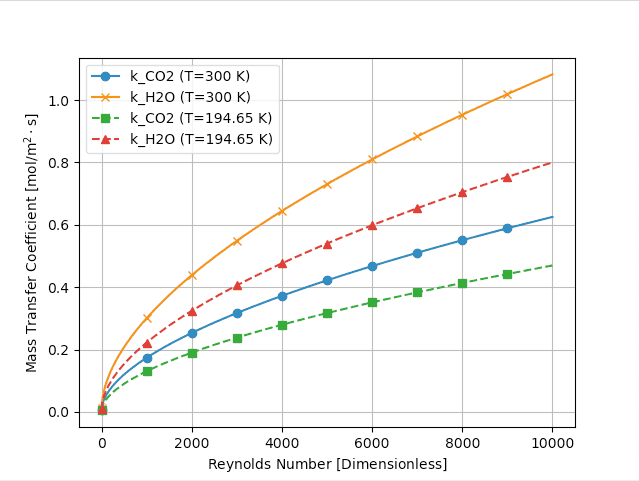

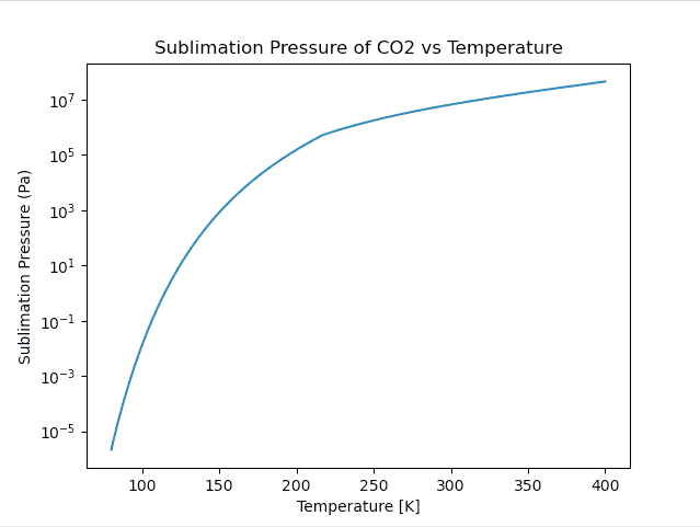

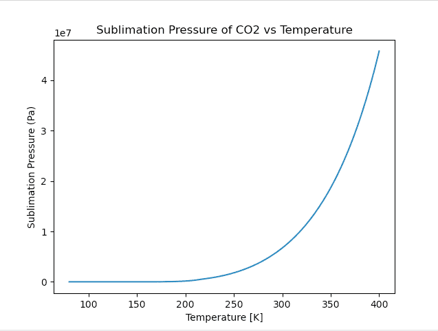

Hi Chet, my apologies for the late response. Here's the vapour-solid (sublimation) curve, where for temperatures above the triple point temperature I've used the vapour-liquid curve. At the triple point temperature, the vapour pressure is 5 bar. Standard scale and log scale:
Standard scale:
Log scale:
If you're asking if the first plot there is for each tank then yes that's correct
##k_{CO2}## seems to be the main variable impacting the max amount of CO2 desposited on the bed. My thought is that maybe my ##K_{CO2}## calculation is incorrect
Printing the Reynolds number and the ##K_{CO2}## numbers for the simulation, the Reynolds number seems to be pretty constant at around 2500. ##K_{CO2}## ranges from abour 0.2 to 0.3 which I think is in agreement with the plot below:
Here is the equation I'm using to calculate ##k_{CO2}##:
##k_{CO2}= (2.19Re^{1/3} + 0.78*Re^{0.619})*Sc^{1/3} * D_{CO2,N2}*(1-\epsilon)/d_p##
Where:
##Sc_{CO2} = \frac{\mu_{CO2}}{\rho_{CO2}*D_{CO2,N2}}##
Where ##\mu## is in ##Pa.s##, ##\rho## is ##\frac{kg}{m3}##, ##d_p## is in ##m##
and ##D_{CO2,N2}## = ##0.144*10^4## ##m^2/s##
The units clearly don't match up here. I know we previously had a molar density term in here. Let me go through this ##k_i## derivation from the start tomorrow

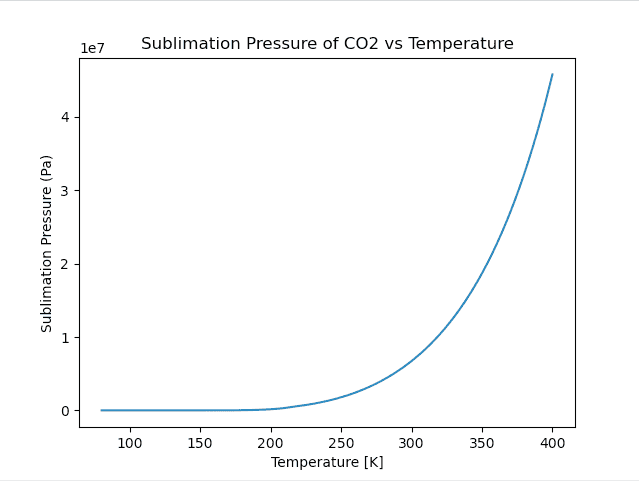

Standard scale:
Log scale:
View attachment 326838If you're asking if the first plot there is for each tank then yes that's correct##k_{CO2}## seems to be the main variable impacting the max amount of CO2 desposited on the bed. My thought is that maybe my ##K_{CO2}## calculation is incorrect

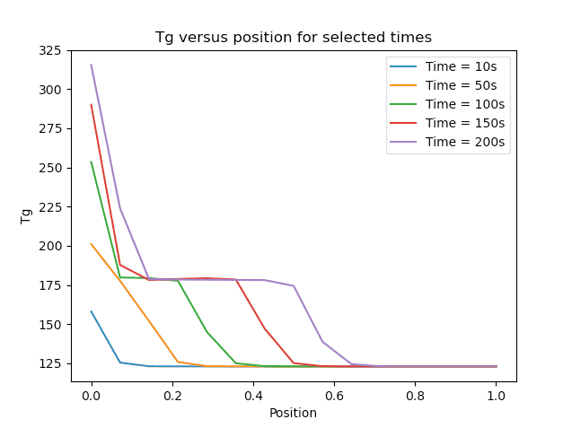

The temperature profiles also look generally ok:
What are the rules to fine-tuning models? Which parameters here can be used as "tuning" ones if any?

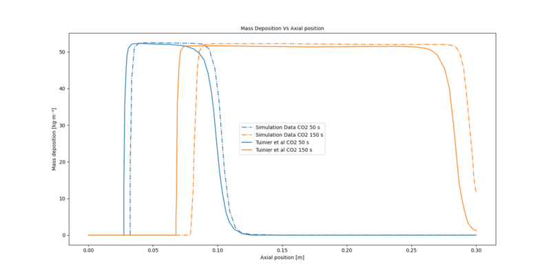

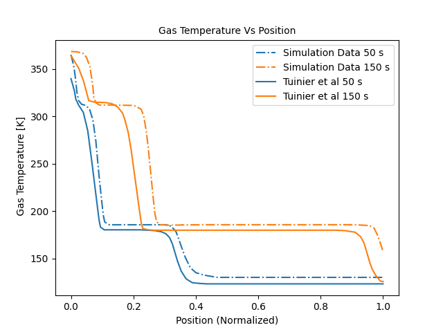

  • #405
Here are the CO2 deposition and temperature profile plots with n=100, not including the ##H_2O## ODEs:
CO2 deposition plot comparisons (our model, Tuinier model):
Temperature profiles:
The deposition profiles are very similar. The temperature profile from our model is missing that first almost constant temperature zone at around 40C. I'm not sure what that is. Presumably its the water freezing but the temperature seems to be a bit high. Besides this it looks pretty good
P.s. My apologies for not providing the same units as Tuinier. I'll get this included in the next version that will have the ##H_2O## ODEs included

Here is the output after adding ##H_2O## back in. It looks good in my opinion. I ran for n=50 because n=100 was going to take too long (I'll rerun now at n=100 to get smoother plots)
Gas temperature:
CO2 deposition:

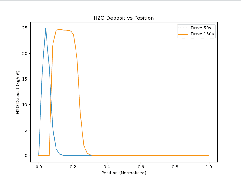

H2O Deposition:
Besides plotting the deposition of CO2 and H2O on the same plot, and fixing the scale units, is there anything you see here as being required in order to consider this model now "fit for use"?
I'll start defining some performance parameters for a parametric analysis if not

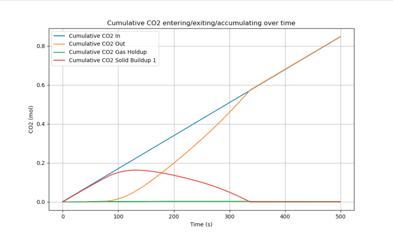

Check of overall mass balances on CO2 and H2O:: cumulative mass in = deposited mass + mass out?
  • #408
My apologies for the delay. It was quite difficult to extract the values of the intermediate variables (molar holdup, molar flow, molar desublimation rate, etc) from the integrator.
So we have -
Cumulative mass in:
##M_{IN,TOTAL} = \dot{m_{in}}*y_{CO_2, IN} * t\tag{1}##
The total molar amount of CO2 leaving the column up to time t is:
##\dot{m_T}## = ##\int_0^t{\dot{m}_n(t')y_{CO2}(t')dt'}##
Total molar holdup of CO2 in the gas phase:
##M_{CO2} = \sum_{j=1}^{n}(P/RT_j)y_{j,CO2}(A_cdz*\epsilon)\tag{4}##
Total molar holdup of CO2 in the solid phase:
##M_{SOLID} = \sum_{j=1}^{n}(M_j)\tag{5}##
(And the same for H2O)
Using these relationships, we get this output:
At long times CO2 in = CO2 out, and at long times CO2 Gas phase molar holdup = CO2 in * number of tanks

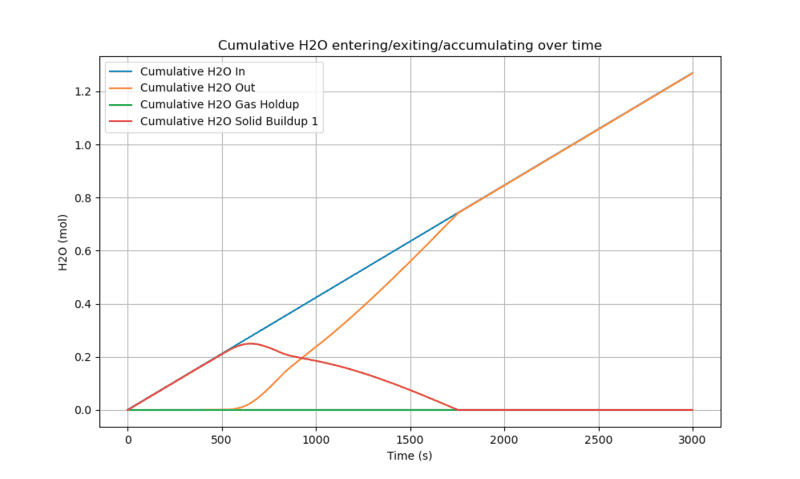

And the same trend for H2O, except the times involved are longer as it takes H2O longer to move through the bed:
If the above looks reasonable, I was hoping to define some parameters that could assess the performance of this system, before running the simulation for suitable ranges of initial/boundary conditions Possibly:
Captured Fraction:
##\eta = \frac{M_{SOLID}}{M_{IN,TOTAL}}##
In addition I was interested in defining a parameter that measures the total amount of energy required to 'capture' a given amount of CO2. This parameter would take into account the energy required to cool the bed (I should have this from the other model), and also the energy required to send combustion gas to the packed bed (via compressor). The idea being to assess different conditions versus this "energy required per unit of CO2 captured" parameter. If you think this is reasonable I'll make an initial attempt at defining that performance parameter more accurately

You should also show a graph of yellow + red + green in comparison to blue to show that CO2 and H2O are conserved. Im surprised that the holdup in the gas within the column is so low, even though all the CO2 and H20 exiting the column exits in the gas streams from the final tank.

The fraction captured should pass through a maximum, after which, at some time, the flow should stop.

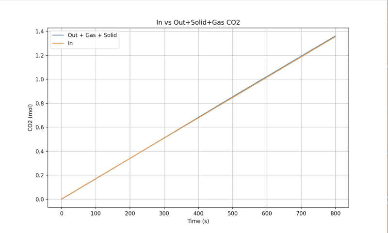

  • #414
Just updating with the mole balance check. Plot of CO2 in vs out+gas holdup + solid holdup:
It seems to be ok based on this plot. Also it matches the Tuinier data well:
  • #415
Considering the differences between the two models, these are excellent matches.
