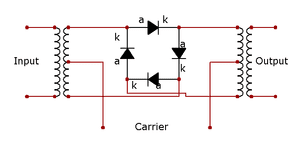

Non-linear Ring Rodulator.
Circuit schematic of a diode ring modulator: input and output transformers at left and right, four diodes in a ring between them, and a carrier connection from a center tap at the bottom.
or linear as with a AM modulator where we have a bandwidth amplitude that's equal to the modulation signal that obeys the principle of superposition.

The signal AM demodulation process (envelope detector diode in this circuit) is non-linear but the actual BFO injection circuit is usually a simple linear signal injection (added to the antenna signal here) like in this simple crystal radio circuit.

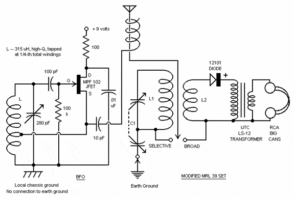

Schematic of a modified MRL 39 radio receiver with a BFO section using an MPF 102 JFET, a tapped 315 uH coil, and a 280 pF variable capacitor, feeding a 12101 diode detector into an LS-12 transformer and RCA Big Cans headphones.

Maybe I'm wrong here but in the BFO example I used no new RF frequencies are generated, only an audio envelope caused by the summing of the two RF frequencies. The detector diode functions as a envelope detector in this circuit. With the RF L1 there is no path for an audio frequency signal to exist or to induce voltage into the diode to audio transformer path.
Maybe we need to stop using the term “mixer”.
To an audio engineer, mixing involves adding signals in a linear device, so as to prevent energy appearing at new frequencies.
To a radio engineer, mixing involves multiplying signals in a non-linear device, so as to cause energy to appear at new frequencies.
Do most receivers do this at IF just before the detector? That makes the oscillator pretty simple. I agree that it is linear. You use to have to use them to insert a carrier for SSB (like the SX-43 I used to have).

A conversion set will usually insert the BFO signal after the last IF stage and just before the detector so the RF agc is not affected. In general for receive CW tone generation you don't want non-linear 'mixing' or audio signal generation as that will tend to generate audio harmonics that sound harsh instead of a mellow 700-1000Hz pure sinewave.
The BFO generates a replacement for a suppressed or missing carrier. The frequency of the BFO is on one shoulder of the IF channel. The IF signal is usually multiplied by the BFO, but in a simple system the BFO is linearly added to the IF signal prior to a diode detector. A capacitor to ground forms the LPF needed to remove the IFs from the audio difference frequency before the audio amplifier input. The diode in that situation is not just an envelope detector, it is also a non-linear mixer.
A similar technique was/is used to transmit a 1kHz master reference signal over frequency multiplexed telephone lines. The 1kHz was not transmitted directly but as the sum of two harmonics, of 2kHz and a 3kHz tones on one telephone line. At the receiver, the one signal with both harmonics was fed through a diode into a 1kHz filter. The output difference frequency of 1kHz generated by the non-linear diode, was independent of the phone line frequency multiplexers.
Concerning the bold and italicized, this is what I have been referring to in the case of the BFO. The oscillator signal and IF signal may be added together (summed) slightly up-stage of where they are actually heterodyned together but ultimately they need be to non-linearly mixed to obtain the audio. Thank you Baluncore. Also, a higher quality SSB or CW receiver is going use more than a simple diode detector and the IF and the BFO will remain separate up until said detector.
