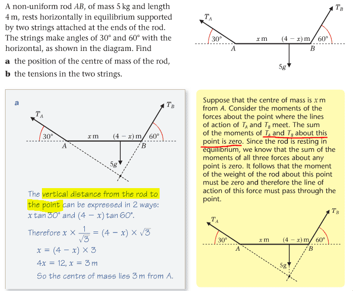

The discussion centers on the confusion regarding the calculation of moments for rigid bodies, specifically questioning the derivation of a particular definition of moment about a point. Participants express uncertainty about the distinction between vertical and perpendicular distances in the context of these calculations. The importance of understanding the correct distance to use in moment calculations is emphasized, as it impacts the accuracy of the results. Clarification is sought on what constitutes the "perpendicular" distance in this scenario. Overall, the conversation highlights the need for a clearer understanding of fundamental concepts in mechanics.
phospho
250
The underlined red part: I don't particularly understand where they got this from?
The yellow highlight: Why are they finding the vertical distance, instead of the perpendicular distance?
The underlined red part follows from the definition of moment about a point. In the yellow part, what would the "perpendicular" distance be?
