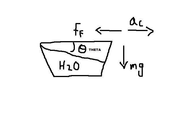

A small container of water is placed on a carousel inside a
microwave oven, at a radius of 12.0 cm from the center.
The turntable rotates steadily, turning through one revolution
in each 7.25 s. What angle does the water surface
make with the horizontal?
v = d / t , F = mv^2 / r
- We obtain speed from the v equation --> v = 2∏r / t = 0.104 m/s
- Then we use the force equation to obtain --> m 0.0901 m/s^2
- Now we do --> θ = tan^-1 (.0901) / 9.8 = 0.527°
I got this from the book, but my question is: Why are they taking 0.0901 as the y-component and not gravity?! The angle is w.r.t. the horizontal, so the opposite cathetus should be mg...
Centripetal accel. is working on the x-axis and mg on the y-axis, right? So, I don't quite get this...
any help?? Thanks!
What's the value of v2/r in the mv2/r formula?
You obtain v by simply dividing the total distance over time, obtaining v = 0.104 m/s.
- Then from the equation for FORCE CAUSING CENTRIPETAL ACCELERATION:
ƩF = (m)(ac) = (m)(v^2 / r )
You obtain acceleration --> (m) [(0.104 m/s)^2 / 0.12 m ] = 0.0901 m/s^2
And then... you calculate the angle by tan^-1 (y/x) , but that's when I get lost... why are they taking mg as the y component? :(
I'm attaching this MS Paint attempt for the free-body diagram lolll maybe the forces are drawn wrong...
Ff stands for fictional force and ac stands for centripetal accel btw
