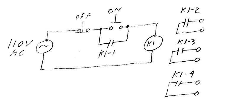

hello guys...
im now doing motor starter for conveyor..so i decide to use 4 magnetic contactor connected with overload relay each..1 contactor for main supply and i make some looping for other 3 contactor each contactor connected to one conveyor... it is 3 phase and 2 poles overload relay..im having some problem on the on/off switch button..right now if I am using push button..so everytime i want to on the conveyor i have to hold it to make sure its keep running..my problem is my boss want me to use different on/off button which mean 1 button on and 1 button off...so i can't figure out how the connection...plus i add one master switch...how can i make it happen?? i try to google the solution but still can't find any solution...so anyone reading this hope can help me..thank you
This is the circuit to use.
If 120 volt is removed and then reapplied, the conveyor doesn't start running.

the motor using wye connection...from what i learned wye connection have neutral wire...so i have to use neutral wire too? because without the wire the conveyor still moving..
