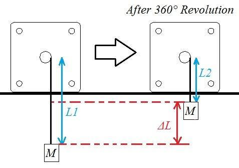

I am trying to experimentally measure the torque of a stepper motor at various velocities. I'm not quite sure how this should be done. Here is a diagram of my proposed method so far:
Basically a weight is to be suspended from the motor by a string, and I will measure by how much the string has moved up after one full revolution. Then I believe the torque must be: ##\tau = m \times g \times \Delta L##. Is this a correct method?
Torque = Force x Distance
I would greatly appreciate it if someone could confirm whether this is a correct method to get a roughly correct measurement of torque (within perhaps ~80% of the manufacturer quotedvalue at a given velocity)?
Do I need to take the shaft diameter into account (or perhaps some other factors)? What is the simplest way of doing this? :confused:
... sort of: the "distance" in question cannot be any old distance - it has to be the length of the moment arm. In your equation ##mg\Delta L## is the work, ##W=Fd##, not the torque.

Another way to measure the torque is to mount the motor on a pivot so the case can rotate (within limits), attach an arm to it with some sort of spring scale on the end.
Also in your diagram the Moment Arm - is the radius of the shaft ( from the center to where the string contacts it- so pretty small) -- so you can decrease the needed weight but adding a wheel/spool to the shaft to increase the radius. By choosing a good radius it will make the calculations easier ( e.g. if you want In*Lbs as units- use a 1" radius wheel)

So, basically, I must measure the radius and use ##\tau= mg \times r##, OR find the angle and use ##\tau = (mg \Delta L)/\theta##?
When the motor turns the string will be wound around the stepper motor shaft, and I must measure the shaft radius with string around it (the amount of string is supposed to change by a minuscule amount whenever I change the speed). I think this would be a very difficult and inaccurate way of measuring ##\tau##...

Neglecting energy that goes to turn the motor components: $$\tau_{ave} = \frac{mg\Delta L}{2N\pi}$$ would be a reasonable approximation.
Notice that's an average for N entire turns. Picking a big value for N will probably be best.
##\vec \tau = \vec F_g\times \vec r \implies \tau=mgr## ...where r is the radius of the shaft, would be the torque exerted by gravity.
Since the stepper motor accelerates around one turn, it must be providing more torque than that.
