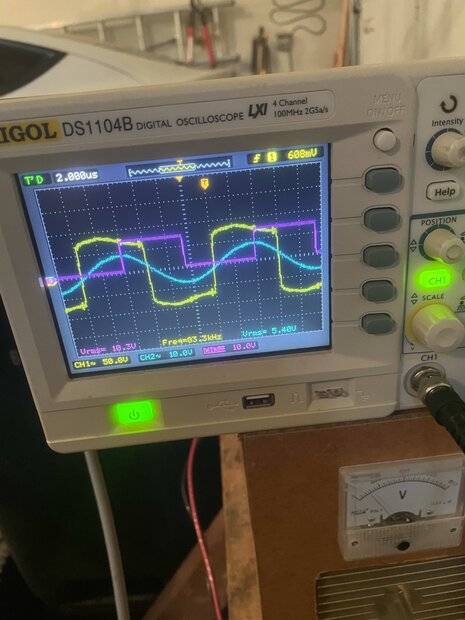

I made a solid ground connection and much as I thought there is no difference. The probes work fine and as you can see if a previous post image, they accurately show the 90 voltage lag on the capacitor when I put the probes across it. I get the same strange behavior with a ground connection and a resistor or capacitor divider:
I do not get 1:100 attenuation; I only get about 1:3
The signal is shifted to the left and distorted.

Made a solid ground. Connected the divider. No difference and still wrong measurements. Then, as a guess I disconnected the p5205 differential probe and held it in the air. I was seeing the strange waveform.
Apparently, my probe has issues and I was never making a proper measurement. I switched probes and now I can see the proper phase shift. I'm still not seeing a 1:100 division, but it is better. I'm going to buy another probe.

The Diff. Probe P2505 only has a CMRR of > 300 @ 100 kHz. or <-30dB error. So a good ground is essential on the signal with a short ground connection. Verify again with both inputs and gnd to gnd for a flat trace.imsmooth10 said:I know the p5205 is no longer serviceable. Any suggestions for a good replacement. p5205a?
Probing the HV output will radiate EMI measurement problems beyond the scope of this thread. only use the C divider output.
You can improve it further with 100 pF\10 nF ( Z(f)= 212 Ohms @ 75kHz to probe.

YES by connecting both inputs to either signal and ground, you are measuring the CMRR and crosstalk. So expect it must be a flat line.imsmooth10 said:You're saying to short the probe ends together or to test them on the grounding lead?

When I connect both leads together they are picking up significant EMI when I power up my device. I suspect something is not working with the probes. Any suggestions to troubleshoot them or the power supply (1103)?TonyStewart said:YES by connecting both inputs to either signal and ground, you are measuring the CMRR and crosstalk. So expect it must be a flat line.

I can get there tomorrow and see what I can do. However, I just connected both probe ends to a ground wire and I do not get a flat line. When I power on a high frequency device nearby I see a high voltage signal on the scope. Not sure what else there is to show. Seems like something is broken.

After switching to a standard probe I was able to get the correct values and waveforms using a resistor divider as well as a capacitor divider. Both worked as predicted.
The problem was with the differential probe and the noise overwhelming the signal. I am done with this thread and will try to address the probe issues in my other thread.

My goals is to get a good zero crossing trace for my capacitor voltage. I was able to get a good noise-free signal with an optocoupler I had lying around. The violet trace is the output when analyzing the capacitor voltage (not shown on the scope).
The problem is that I need a resistor to limit the maximum current to the LED to 25ma, which increases the voltage necessary to get the coupler to start detecting a lower voltage.
I'm trying to go through the data sheets on mouser and digikey to find one that has fast switching, low turn-on voltage, minimal propagation delay and a diode that can tolerate a higher current to give me the ability to detect a voltage ranging from 0-500Vrms.
Any suggestions for a good optocoupler/isolator?

Why, or what will you use the signal for?imsmooth10 said:My goals is to get a good zero crossing trace for my capacitor voltage.
You need to write some specifications. How do you define "good" ?
An optocoupler and resistor is not the solution if you want a crisp edge at the right time. An optocoupler will always switch a few volts late, while resistor current will be lowest, just when you need it to be greatest, and greatest when you want it to be lowest.
There are many solutions, each with its own pros and cons.
It seems you do not want a pulse on crossing, but a square wave that is in phase with capacitor polarity. How close to in phase?
Do you require symmetry, or can the wave have a fast rising edge with a slower falling edge?

I just seem to go deeper into the rabbit hole.
Baluncore, you are right. I don't want pulses on zero crossing, but a square wave that closely matches the polarity of the capacitor, Symmetry would be preferred.
Tony, the Falstad applet was really nice. I'm sure much of what I think is wrong so I am ready hear the right answer:
I thought the purpose of the isolator was so two dissimilar circuits could get "linked". The diode simply needs current from a closed loop to turn the other side on and off. Why does the left side of the circuit need to share a ground? Can't I run the left side with a non-grounded, floating sinusoidal voltage source?
Also,
1. What's the purpose of the schottky diode? When I delete it nothing seems to change.
2. What is the purpose of the 1M on top of the 100pF capacitor in parallel? You have capacitance 100:1 divider.How are you are picking the value of the resistor to go with the 100p capacitor?
Also,

The 100 pF was a current limiter voltage divider. The 1Meg and clamp diode were redundant for a unipolar signal 0 top 400V.
now I AC coupled reduced current to <4mA and phase shifted diode current 90 deg. The 10k senses current limited by the C reactance with some tiny fringe effects on duty cycle.
duty cycle is 50% +/-2 https://tinyurl.com/2pyrb6a2

In both of your applets will the isolator's diode work when the AC source voltage is very low? I see it works on the simulation. The issue I was having was at low voltages there was not enough current to turn the isolator's diode on.
Also, the phase error addition aside, what is the functional difference between the two applet's output?

When input current is low, you raise collector R value the same and buffer as I did. The diodes capacitance is not modelled so there are freq. limits and also tolerances on hFE are not an option there.
Often the opto losses are near the hFE gain so you see the CTR specs. are near 1 or worst case maybe 10% and best case >> 100% but the biggest variable in production is hFE. (depending on p/n)

The diode, in antiparallel with the optocoupler LED, prevents destruction of the LED by reverse voltage.
The greatest slew-rate of the capacitor voltage is at the time of the zero-crossing. It would be sensible to use a capacitor to deliver the current needed to drive the optocoupler LED. The gating of that current through the optocoupler could be done by the capacitor voltage.

meaning:Baluncore said:The gating of that current through the optocoupler could be done by the capacitor voltage.
Since I chose a small series C , its impedance being highest by far the 90 deg. Phase shift is dominated by Vc drop and < 1% by load= Vf/If +Rs, so the phase error is low.
Since the largest voltage drop is across C and current sensed by the real R (albeit nonlinear diode effect, it is still real R. for the most part neglecting low current diode capacitance)
In the initial divider we had matched R1C1 to R2C2 to get a wide spectrum voltage divider rather than the familiar partial derivative frequency response.

You're referring to the 10k resistor as the current sense, right?. If the voltage goes up on the cathode side of the LED diode doesn't that decrease the voltage drop across the diode and hence the current driving it? When you say "raise" the collector R are you saying you choose different design values? My issue is the voltage source varies from 0 to 500Vrms and the value of R would be fixed.TonyStewart said:When input current is low, you raise collector R value the same and buffer as I did. The diodes capacitance is not modelled so there are freq. limits and also tolerances on hFE are not an option there.
