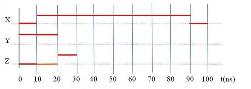

This is just an example/solution to a timing diagram/gate delay for the circuit of logic gates. I am reading ahead of the chapter on gate delays & time diagrams, however, the book doesn't provide as much information. I am unsure how the solution came about in drawing their timing diagram from scratch, and thought maybe someone could help clarify this to me? Are they simply taking consideration of the time delays FIRST or the initial states FIRST?

Hello Phyzguy,
Yes, I understand the set up for the initial states. Here is what I have so far:

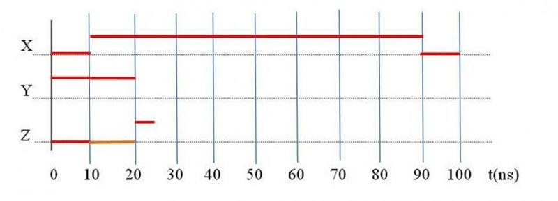

Initially X=0, Y= 1, and the output became 0. So as '0'--the output, makes its way to the inverter, there is a 5ns delay (which I denoted in ORANGE) before actually "inverting" from '0' to '1'. As X and Y makes its way to the and gate, there is also a 10ns which I also denoted in orange. Am I on the right track?
Also in the graph that I've drawn...is it correct or not that I draw a '1' of only length 5ns in the 'Z' row (from 20ns to 25ns) , or must it extend from 20-30ns? That is the part I am confused with, and as continuing with the completion of the graph. Any advice would be appreciated. Thanks!
I don't understand why you have the orange line from 10-15 ns in Y. You should assume at the beginning that the signals X,Y,Z have been in their states for a long time and nothing is changing. Then at 10ns, X changes from 0 to 1. This will not cause any immediate change to Y, since Y is not dependent on X, so why do you have an orange line in Y? ? However, after 10ns, the change in X will lead to a change in Z (the orange line and the change in Z at 20ns look correct). If nothing else changes, Z will stay that way forever, not just for 5 ns. However, the change in Z causes a change in Y 5 ns later, and that change in Y causes a change in Z 10 ns later. Does that help?
Okay I thought about what you said..but I still have a question..
If I understand you correctly, as x changes from either 0 to 1 or 1 to 0, then a 10 ns delay is considered for Z. As for when Z changes from 0 to 1, or 1 to 0, then a 5ns is considered for Y.
So INITIALLY, I see that X=0, Y=1, and Z= 0.
Then I see that X changes from 0 to 1. Okay so that means we will consider a 10ns delay for Z. Y remains unchanged.
Next, when Z's output becomes 1, Z changes, so then there will BE a 5ns DELAY, correct so far?...X remains unchanged--still '1'. so we DONT take consider of a 10ns delay.
My question is about drawing the graphs...
which one is appropriate, the first or second? I am confused on whether drawing only a '5ns line' on row Z or a '10 ns line'.
Well, neither one is correct. You should draw a 15ns line for Z. After Z transitions high, it will stay high until 10ns after one of the inputs to the AND gate changes again. X will not change until much later, so when will Y change? Y will change 5ns after Z changes. So Z will stay high for 15 ns. I think what you are missing is that, while it takes 10ns for a change to propagate through the AND gate, after the output has changed, the output will retain its state indefinitely until one of the inputs changes again. It doesn't just go high for 10 ns and then go back where it was.

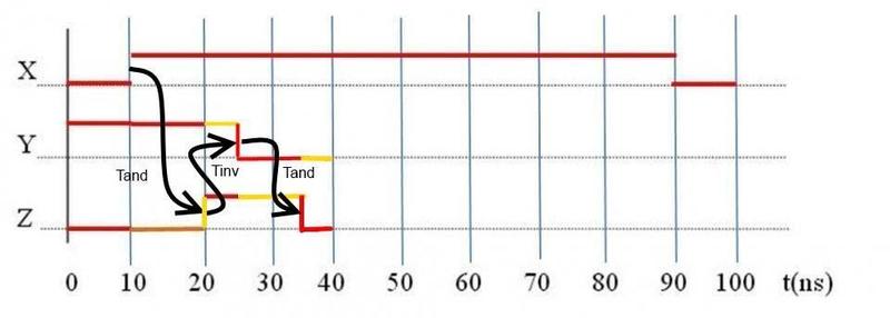

What phyzguy said. I prefer to draw arrows on the drawing to show the delays..
