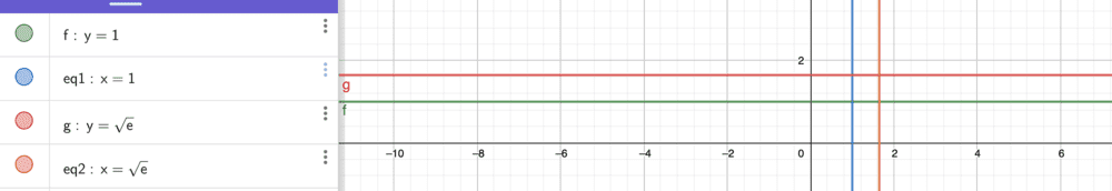

Not sure how to use latex formatting for the question so I have moved it to the main body ....
\begin{array}{c}
1 \leq x^{2}+y^{2} \leq e \\
1 \leq x^{2} \leq e \quad 1 \leq y^{2} \leq e \\
1 \leq x \leq \sqrt{e} \quad 1 \leq y \leq \sqrt{e} \\
x=1 \\
x=\sqrt{e}
\end{array}
*Similarly for y which gives a rectangular region in the first quadrant.
Is the above simplification the correct way to proceed?

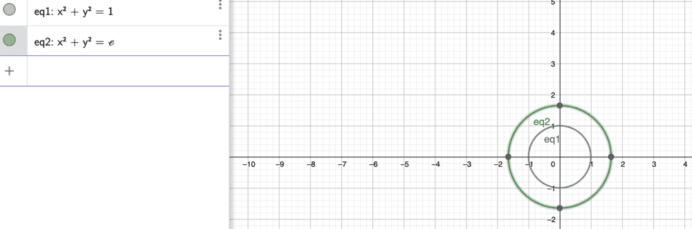

What is the shape described by ##x^2 + y^2 = 1##? And what about ##x^2 + y^2 =e##?
Oof! Didn't think of it that way, not sure why I made the inference that I did...
Although this must somehow be self-evident, I would appreciate it if you could walk me through the reasoning for it...
... I'm not sure that the equation of a circle needs further explanation.

Well the inequality ##1 \leq x^{2}+y^{2} \leq e## is really two inequalities: ##1 \leq x^2 + y^2## and ##x^2 + y^2 \leq e##. Perhaps more simply, you can say the radial coordinate ##r \in [1, \sqrt{e}]##.
