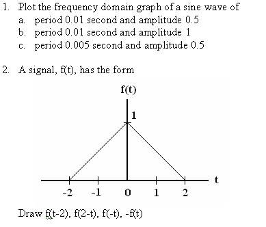

Question as below

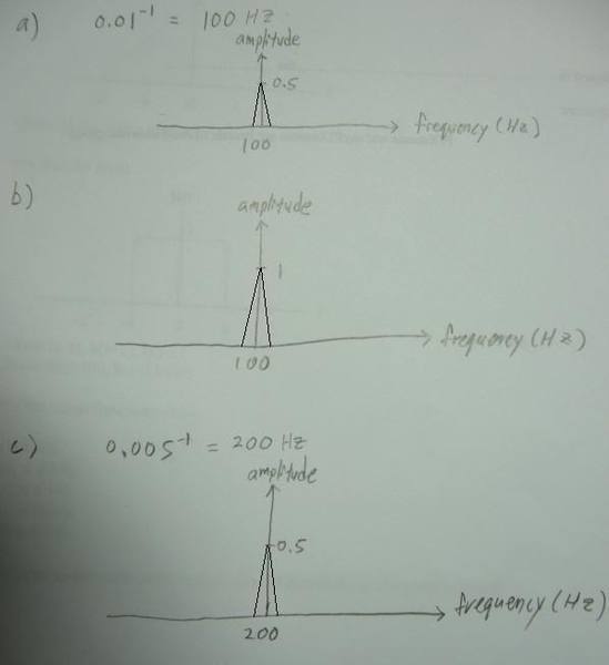

My answer for Question 1
Is that the right way to present the signal?
My answer for Question 2
For f(t-2)
For f(2-t)
For f(-t)
For -f(t) [Not really sure about this] Am I do it correctly?

A sine wave in the time domain has a delta function representation in the frequency domain. The height of the delta function is related to the amplitude of the sine wave; the position along the frequency axis is related to the frequency of the sine wave. Obviously, smaller period implies higher frequency.
The answers to question 2 appear to be correct.

Am I doing it wrongly?? Since the amplitudes are given as 0.5 for part a) and part c) and 1 for part b).. That's why I just wrote them on the frequency domain.
Is that any possible way for you to show me something in picture?? Thank Alot for your help.. Appreciated

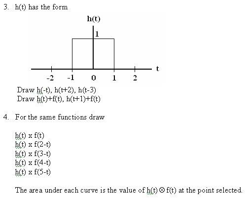

Anyone here know how to add and multiply two function together??
Question Part1
Question Part2
