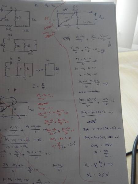

Hi everyone. I need some help with regards to a question on Thevenin's equivalent. I attempted to solve it in 2 ways but I got different answers when I tried to do it another way. However, I am not sure of my answer as I do not have the answer key at the moment. The picture below shows one of my attempts at solving it, arriving at the answer, V2 = 2.5V, which gives VOC = -2.5V. My workings are bordered by the red line. Pardon me for the messy working as I was in a rush.

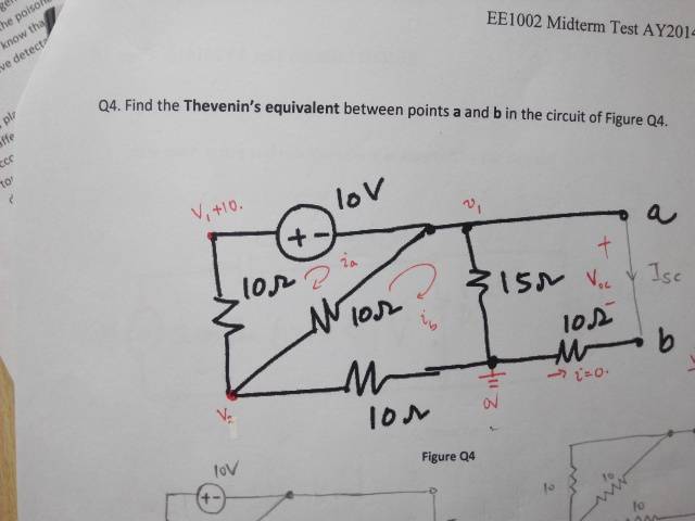

The question is below: (Please ignore the red markings and the pencil markings.)

The result that you've achieved for the Voc in your work looks good.
The 2.5V figure for V2 checks okay.
In your S/C diagram I can't see that 5Ω resistance coming from anywhere.

Hi NascentOxygen. Thank you. What do you mean by the 5Ω resistance? I didn't write any 5Ω resistance in my working, at least for the workings enclosed by the red line. :)

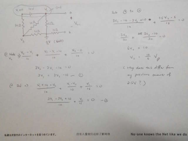

Here is my alternative approach, which was what my teacher wrote on the board, but I got a different answer for V2, which is supposed to be 2.5V. May I know what is wrong with my approach? I suspect it has to do with me putting GND between the 2 10 Ohm resistors.

V2 is the voltage at an internal node, it is not the voltage measured across the terminals. You have yet to determine the terminal voltage here.

Oh ya! I see my mistake now. >< Sorry. Thanks! :D
