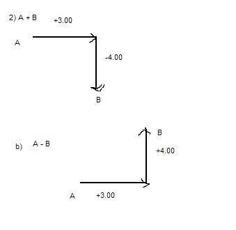

2) Vector A is 3.00 units in length and points along the positive x-axis. Vector B is 4.00 units in length and points along the negative Y-axis. Use graphical methods to find the magnitude and direction of the vectors. A) A + B and (b) A - B
I have attached my attempt.

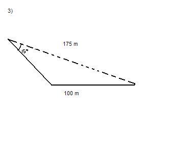

3) A jogger runs 100 m due west, then changes direction for the second leg of the run. At the end of the run, she is 175 m away from the starting point at an angle of 15.0 Degrees north of west. What were the direction and length of her second displacement? Use graphical techniques.
My drawing attempt is attached.
For this problem.. i don't really see another way of coming up with the answer unless i use the law of sins. My teacher specifically told us not to though.. he said these questions could be done with simple trig. I have no idea what he's talking about though, i think I am just an idiot:confused:

Problem number 2 looks good.
In the third problem, your 15 degrees is in the wrong place. The direction to the final point from the initial point is "15 degrees north of west". That means that the angle at the initial point is 15 degrees up from the horizontal (the horizontal is "west" and up is "north"). Draw the picture in scale and measure the length and angle of the second leg.
ah thanks a lot halls, i understand now
