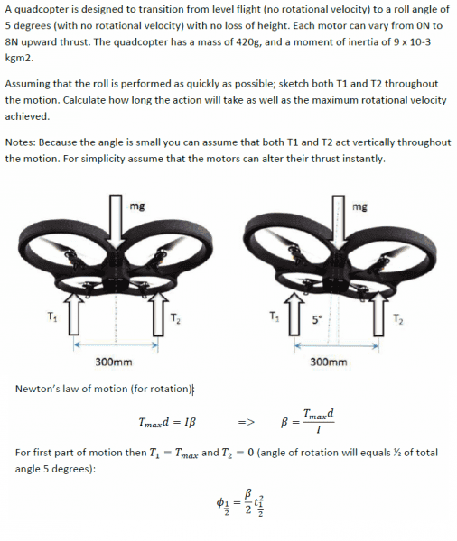

Hey guys,
I'm trying to work through a question but the solution we have been given is extremely vague. I can't seem to figure out what any of the values such as Beta or Tmax are. If I knew how to work those two out, I'm sure I'd be fine from there...
See attached image.
Thanks in advance

Luchekv said:
Hey guys,
See attached image.
Thanks in advance
It looks like T is the thrust from each motor, so ##T_{max}## would be the maximum thrust. And from Newton's 2nd law for rotation, Torque = I*alpha, you should be able to deduce what Beta is.
Well seeing as T1 is Tmax...(8N) I get Beta as 888.889...Not sure if it means both T1 and T2. Also what would be the value of t in the second equation at the bottom?
Careful. What must the total thrust be so as to maintain the height? Also, what value of d are you using?
The purpose of that equation is to solve for ##t_1##.
