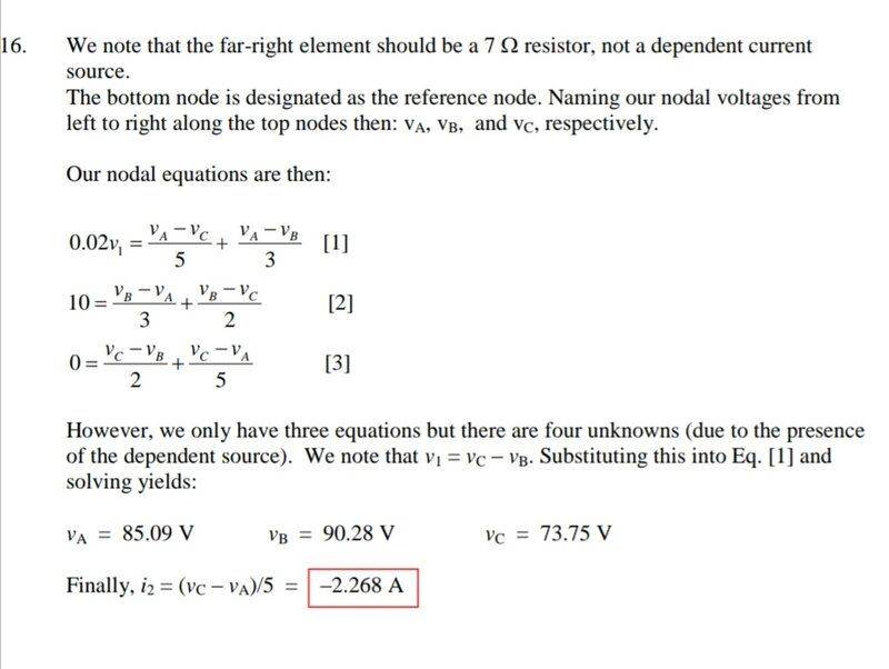

The solution manual answer is weird, they put a resistor instead of the left current source, but didn't include it in the equations, I'll just attach it.
So we have an exercise with a picture that has a current source ##0.2\, v_2## instead of a resistor of ##7\, \Omega## and a current source that says ##10 \,V## ? Anything else ?

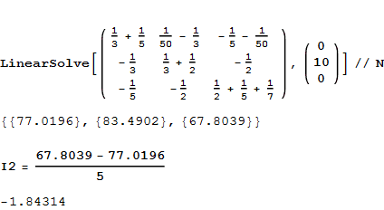

The answer in the solution manual is totally messed up!
First of all, without some path to ground (which the 7 ohm resistor provides), the original problem from post #1 of this thread has no solution for the voltages at the nodes, although I suppose one could say that I2 = 0 anyway.
The addition of a 7 ohm resistor makes a solution possible, but the equations they show are incomplete; they haven't included the 7 ohm resistor in the equations! The equations they show have no solution so where did they get those numerical values? I have no idea. The third equation needs a term +Vc/7 at the end. If that is added, then we have a solution:
The resistor is in place of the right current source.
Yeah it's completely messed up, and I couldn't figure on what basis they changed the question. So I'm sticking with the solution that I ended up with in my previous reply.
