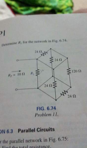

Engineering Not sure how to do this complex circuit
  • Thread starter Thread starter Unidan
    Circuit Complex
To determine if the two 24-ohm resistors are shorted, identify which resistors have their ends connected by wires, effectively bypassing them. The discussion emphasizes understanding nodes and the concept of admittances in parallel, which add together. The user is encouraged to simplify the circuit by replacing shorted resistors with wires, reducing the complexity to four resistors in parallel. Visualizing the circuit in a simplified, two-dimensional format can aid in understanding. Overall, the conversation highlights the importance of breaking down complex circuits into manageable components for easier analysis.
Unidan
My friend told me the 2 24 are shorted. How do I know these are shorted and b) what do I do do make this question simple?
1. Have you studied yet what is a "node" ?
2. Have you studied that admittances in parallel add ?
3. I see four 24 ohm resistors not two.
4. How do you make the problem simple?
Look at it. Which of the resistors is shorted out by wires connecting its two ends ? Replace it (or them) with wire. Then it's just four resisitors (or admittances) in parallel.

Thanks for your reply Jim!
1. Yes. A node is where 2 or more elements are connected to.
2. I have not. I am a first year student and this is only my 4th week at school.
3. Yes, my mistake.
4. This is where I am not understanding. What are you meaning by a "short" ? Here is a little video I made to explain what I mean: https://vid.me/2W3D

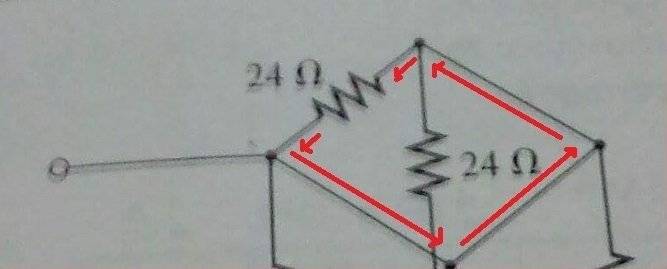

A component is said to be shorted when potential difference across it becomes 0. Here, if the same wire is connecting both the ends of a resistor, the resistor is shorted. No current will flow through it. All the current flows through the wire, bypassing the resistor.Hence, it is replaced by a wire.
A picture of what Mr cnh said
AHA ! That diagonal 24 ohm resistor might as well not be there. It's two ends are connected by wire. So you could replace it by a wire. Or you could just erase it since (assuming no magnetic effects) no current flows through it.

i see four dots in a plane at the top of that structure. Looks to me like they're a single 'node'.
ow about the bottom ?
Might be worth simplifying and re-drawing that circuit . That's how we solve complex circuits, simplifiy them one step at a time.
Can you redraw it in one plane instead of three dimensional ?
