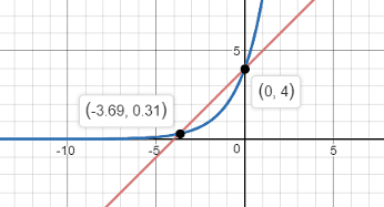

Find the solution(s) when: 4+x = 4(2)^x
I only know how to solve this problem using graphing. I'm not sure how to do it algebraically. Please help.

Some problems do not have a nice easy algebraic solution. The (0,4) is easy enough to guess and also verify.

As scottdave has indicated, some problems do no have nice solutions, and this is one of them. However, some have not-so-nice solutions, as does this one:
$$x = 0 \; \text{or} \; x = -4 - \frac{1}{\ln 2} \text{LambertW} \left( -\frac{1}{4} \ln 2 \right) \doteq -3.690093068 $$
Here, LambertW is a non-elementary function that does not have an explicit, finite formula, but has known series expansions and can be approximated numerically to as much accuracy as you want. You will not find it in a spreadsheet, but it is available in computer algebra systems such as Maple and Mathematica.

You can apply some numerical methods. One is an iterative method (http://tutorial.math.lamar.edu/Classes/CalcI/NewtonsMethod.aspx)
You should write the equation to be solved in the form x=f(x). It works in the domain where |f '(x)|<1
The problem becomes very simple if you switch to the variable y = 2+x. The equation becomes y=2y-2. It converges quite fast for y<0.
Substitute some initial value for y, you get the next value, y1. Substitute y1, you get the next approximation, y2.
Continue till |yn+1-yn| are close enough.
Starting from y= 0, we get -1, -1.5, -1.646, -1.680, -1.688, -1.689, -1.690...which corresponds to x=-3.690.
The derivative of 2y-2= 2ylog(2) is greater then 1 for y>0.529. To get the other root (y=2), an other iterative function is needed: y=log(y+2)/log(2).
