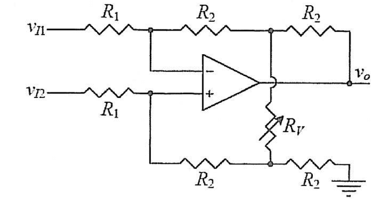

Op-amp difference amplifier circuit with inputs vI1 and vI2 through R1, feedback resistors R2, a variable resistor Rv from the output stage to a node tied to ground through R2, and output vo.
to prove vo=(2R2/R1)[1+R2/Rv][vI2-vI1] and Rv is variable resistor

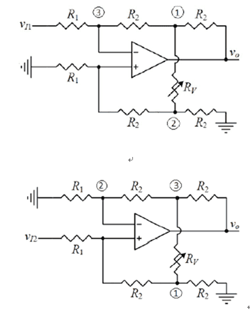

Two op-amp difference amplifier circuits, upper with input vI1 and lower with input vI2, each with R1, R2 and a variable resistor RV in the feedback path, output vo, with node labels 1, 2 and 3.
upper: 2 is 0V? and then Rv,2R2 form a t-network?
bottom:3 is 0V? if not how can i calculate?[/B]

No, you don't know what the current from (3) to (2) might be. So you cannot say that V(2) is zero.
No, you cannot know V(3) without knowing both vo and vI2.
You'll need to analyze the circuit from first principles, perhaps using nodal analysis and the properties of an ideal op-amp.
I think, it is a good approach to use superposition - as proposed by you (setting one of both input signals to zero).
Nevertheless, the remaining circuits are still pretty involved and - as suggested by gneill - you should use nodal analyses for both solutions.

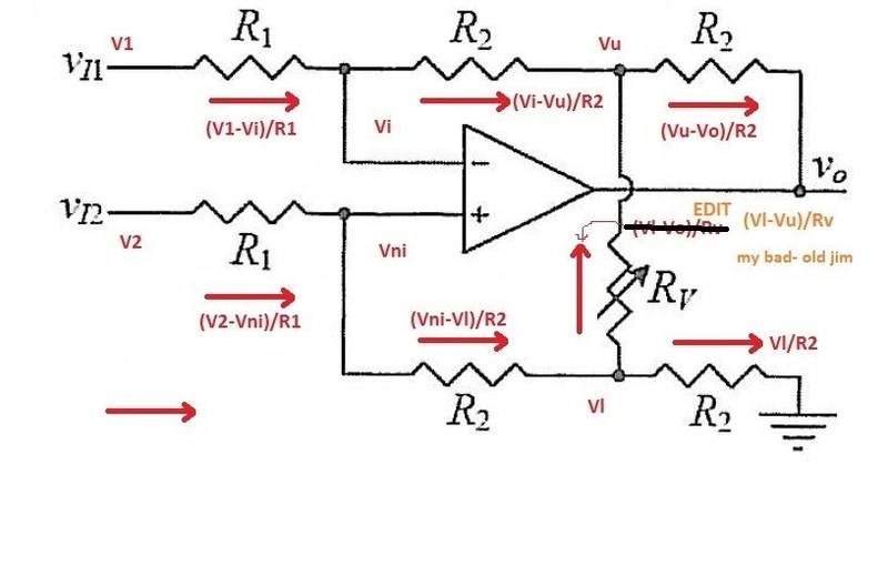

So let's draw your circuit and label some nodes for convenience
Let's call the voltages at nodes where Rv joins the R2's Vu(pper) and Vl(ower)
and voltages at opamp input nodes Vi(nvertng) and Vn(oninverting)

What do we know? What remains unknown ?
V1 and V2 are inputs, so they aren't unknowns
All resistor values are known, if only by their identifying labels
Well,
if the circuit "operates" then Vi = Vni
meaning Vi and Vni are unknown but equal,
so they count as only one unknown Let's call it Vx
Vu and Vl are unknown, so is Vo
So i see four unknowns. Vu, Vl, Vo and Vx.
Can we write four equations to solve for those four unknowns ?
KCL says we can sum currents at nodes Vu and Vl
EDIT , to fix a mistake on my drawing (Thanks Tom G ! )
node Vu: (Vx - Vu)/R2 + (Vi -Vo)/Rv - (Vu - Vo)/R2 = 0
node Vu: (Vx - Vu)/R2 + (Vl-Vu)/Rv - (Vu - Vo)/R2 = 0
node Vl: (Vx - Vl)/R2 - (Vl - Vo)/Rv - Vl/R2 = 0
node Vl: (Vx - Vl)/R2 - (Vl - Vu)/Rv - Vl/R2 = 0
Since input current to the operational amplifier at the heart of this operational amplifier circuit is zero,
Again using KCL , summing currents at nodes Vi and Vni gives
node Vi: (V1 - Vx)/R1 - (Vx - Vu)/R2 = 0
node Vni: (V2 - Vx)/R1 - (Vx - Vl)/R2 = 0
I count four equations and four unknowns... should be an algebra problem from there...
You're looking for Vo as a function of V1, V2 and the three resistor values R1 R2 and Rv.
Now - my algebra is rusty and i get absolutely frustrated trying to do it on a keyboard
so i'd do it longhand several times and see if i get same answer.
That is my "Poor Man's approach" to Opamp circuits:
Set voltage at amplifier inputs equal and solve using basic circuit analysis.
(in my case "Poor Man" meaning one like me who was endowed with a meager portion of mathematical ability)
Let me know if those four equations aren't adequate. Re-Derive them yourself.
Remember that key point - opamp must be allowed to force its inputs equal else the circuit can't "operate" .
