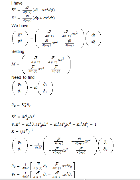

Trying to find your Orthonormal basis
243412
Is this correct? If not any hints on how to find
243413
Many thanks
It seems to me you are missing some sign in your definition of M. Otherwise notationally dubious but in essence fine.
Also, wouldn’t something like ”the black adder” sound better?
thanks Orodruin very helpful, But I think I have a better idea, I think I'm missing a sign in my definition of M :)
