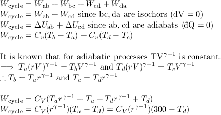

(a)(i) has me completely baffled. I understand that the work is the area bounded by the two adiabats and the vertical isochors, but I don't see how this is related to the efficiency if η = 1 - r1-γ = 1 - (|QC| / QH).
That relation gives me a value for (a)(ii) of |QC| = QH*r1-γ - 200*10.6-0.4 = 77.8 J, though; is this on the right lines?

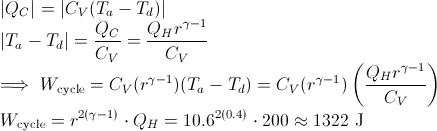

I've had more of a look at (a)(i), and I've gotten a bit further, although unless I can use the efficiency to get past the problem I've encountered in my last line, I'm not sure I've done it the way the question wants (if it's right at all)?
The issue now seems to be finding Td?
Edit: Okay, I think I got the efficiency into the picture, but the value I come out with seems ridiculous; 1320J of work for 200J heat input seems all kinds of wrong?
