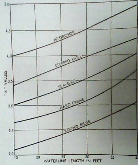

What is k in the HP formula and which diagram are you referring to
Baluncore said:
k = 2.4 where v = k * Sqrt( HP / d ); in units of knots
Baluncore said:
Based on my old diagram, that makes k = 2.4
The 2.4 was an empirical coefficient for hard chine displacement hulls.
The diagram was in an old book on boat design, that gave a guide to hull speeds for powers, with different types of hull and mode of operation. I will see if I can find it again. There are probably better references now.
@sami173 Welcome to PF.
Fast Boats. A Guide to Speed Under Sail and Power.
By John Teale. 1961. Diagram is on page 27.
For a 25 foot water line length, the rounded hull had k = 2.4 while the hard chine had k = 2.9
I conservatively reduced the speed estimate for power by using the lower k value for a rounded hull.

Can i get value of k for a pontoon
It depends on the section, and how fast you push the pontoon.
At slow speeds, it will act like a rounded hull or a hard chine, depending on the section.
If it planes, with the nose out of the water, it becomes a sea sled.
