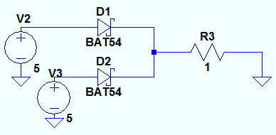

Hi, I am trying to make one of my project plug into the wall. It needs 150 Watts, at 12 volts. I am going to use laptop chargers to power it, but I only have 2, 75 Watt chargers.
Both of the chargers are 12 volt chargers, and I was wondering, could I use these two chargers in parallel to achieve my 150 watts?
I do not have money to buy another laptop charger, and was wondering, if i could have them in parallel, how would I go about doing that?

150W @ 12V is quite substantial = 12.5A and if that is what the load needs, then you are going to require somewhat more
than that to have some headroom ie. around 175 - 200W ... now you are up to around 15 Amps
best option would be to use a PSU out of a desktop PC get one that can produce around 15Amps on the +12V railDave

in a simply world, yes, you could just parallel the two supplies, this would give you twice the capability at the same voltage
but the world isn't simple or perfect, nor are power supplies and if the supplies are not exactly identical in their outputs
(highly unlikely that they would be) ... then one will be likely to supplying more of the current than the other
Unevenly shared load means one supply works harder and is likely to fail quickerYou also didn't comment on my comments re max power needed by the load and the need to have headroom above that amount
you unclearly hinted that you need 150W, I said if that is the case, then you need a power supply capable of more power out
so again ... what is the maximum load ? is it 150W or a lot less ?

You may be able to diode OR the two chargers, using two high current Schottky diodes. That might give you an overall 11V at 150W maximum load. How sensitive is your project to the input voltage?

how exactly would I go about doing that?
Use Google Images, and search on Diode OR Power Supplies... :smile:
So this is the sort of thing you are talking about?
and this would work, and solve all issues?
That's what I was referring to.
Would it "solve all issues"? Not necessarily. As I alluded to, you lose voltage across the diodes, so you will likely be down around 11Vdc at the max 150W load. Also, that's a lot of current for a diode, so you will need to be sure to use Schottky power diodes that can handle the current (and they may need head sinking). 150W/12V = 12.5A, so you would need to find some 15A or bigger Schottky diodes and heat sink them properly. The BAT54 shown in that image is tiny, for example, and only rated at something like 100mA.

So would it be possible to power this as two half matrices?
Open collecter drivers should not care where the power comes from.

In general it's not possible to diode power supplies like that. This is because some semiconductors have a positive temperature coefficient and some have a negative. With the positive (I think) one draws slightly more power, gets hotter, then draws more still until it dies. The negative gets hotter, draws less power, the other picks up the slack and both work fine.
So it's at best a 50-50 shot if it works (BJT vs. CMOS, BTW). So there is some risk to equipment and conceivably a risk of fire.
Also you shouldn't push your power supplies beyond about 50% of nominal for projects like this. Power supplies are rated for nominal maximum with specific equipment. Guessing is a good way to blow things up.
My worry is more to do with the interaction of the regulation feedback loops.
If PSU A notices a slight rise in voltage, it will try to reduce its output. PSU B will then see a fall in voltage and try to increase its output, which makes it worse for PSU A, which further reduces output, etc. Until PSU B is supplying its maximum output. One PSU ends up trying to carry the whole load.
Paralleling regulated supplies seems to be an inherently unstable situation until one of them current limits.

That is certainly possible if the voltages are poorly matched. But remember the extra diode drop which should cover the effect.
In this case, the 12V power bricks will have current limiting, so they will balance out the power draw near max current output.

Nah, the maximum power supply ratings are just that. It should be fine to run them near max power for extended periods of time. Unless they are of poor quality or something.

This is the best idea so far. Divide the project up into two power domains... :smile:

And what manufacturing company ever used cheaper substitutes when they could use the engineer specified part? [sarcasm]
Relying on current limiters and unknown safety circuits is poor practice, IMO.
