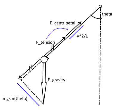

Consider a realistic pendulum with a bob of mass ##M## and a rod of mass ##m##. For the purposes of torque, is it correct to treat the bob and rod as two separate point masses, one at length ##L##, and the other at length ##\frac{L}{2}##?
When I implemented this idea, I found that centripetal acceleration increased by a factor of ##\frac{3}{2}##
The only change I detected was that the center of mass of the bob/rod combo shifted closer to the pivot, which increased the frequency of motion. In this case, the total mass had no effect.
This is the force analysis I used for a massless pendulum. For the massive pendulum, I treated the rod as a second point mass at length ##\frac{L}{2}, with its own set of forces. I then added the forces together. The acceleration due to gravity did not change (the bottom blue line), but the centripetal acceleration increased (the top blue line).
I did not specify any density information, and the pendulum swings faster, but independently of the added mass, which leads me to conclude that this is a spurious result.
If so, how should you model a pendulum with a massive rod? I'd prefer a purely force-based model (rather than Lagrangians, which I've never been introduced to)
Find the centre of mass of the system of rod and bob. Then treat your pendulum as a massless rod with a point mass of M+m at the centre of mass. For small perturbations of a pendulum the period is related only to the length between the pivot and the centre of mass, not the mass. The pendulum clock in Westminster (colloquially known as Big Ben), was once (is still ?) regulated by adding or subtracting pennies from the top of the pendulum bob. It was not the extra mass that made a difference but the raising or lowering of the centre of mass.

Thanks, that was very informative - and elegantly simple in retrospect. It turns out the behavior of a pendulum with a rod with mass is simply isomorphic to a pendulum of slightly shorter length, and the only added complexity is finding the center of mass.
To calculate the torque, yes. But you need to treat it as an extended body to calculate the moment of inertia.

Ah, that clears it up a great deal. Nice analogy. I see now: I calculated the torque correctly using that method, but I neglected to take into account the moment of inertia - which itself is proportional to the distance of the center of mass from the pivot point.
