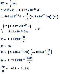

The position and momentum of a 1KeV electron are simultaneously determined. If its position is located to within 1Angstrom (Δx), what is the PERCENTAGE of uncertainty in its momentum?
ΔxΔp >= h(bar)/2
Δx = 1A = 1x10^-10m
Δp>= h(bar)/2Δx
Δp = 1.055x10^-34(kg/m^2)/s
2(1x10^-10m)
= 5.275x10^-25 kgm/s
how do I get the percentage of uncertainty?
(\Deltap/p)100.
Use the energy to find p.
Thanks!
Here's what I did...
(I don't know how to use latex =/ )
KE = 1/2 mv^2
1 x10^3 eV = 1.602 x10^-16 J
1.602 x10^-16 J = 1/2 (9.1 x10^-31 kg) (v^2)
Sqrt[(2 (1.602 x10^-16 J))/(9.1 x10^-31 kg)] = v
v = 1.88 x10^7 m/s
p = mv
p = (9.1 x10^-31 kg) (1.88 x10^7 m/s)
p = 1.708 x10^-23 Kgm/s
Δp/p = .031 = 3.1 %
or click the attachment=)
